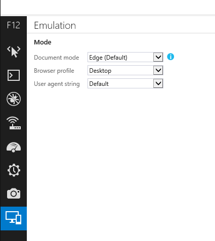

          Do as suggested to the original poster and press F12. You will get a window that at the bottom left, will show something like this:
          35591-CaptureF12
          Click the icon shown in blue and choose Edge from the Document mode dropdown, as shown in the picture.
          This should solve your problem. If it doesn’t, maybe try choosing 10 or even 9.
