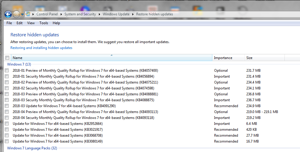

        • #186172
          Is there any action which a user can take which will show ALL of the hidden updates instead of just the last FOUR?
          Walker, I ran into a similar issue when I once checked my hidden updates and saw that I had none, even though I knew I had many.
          Try this: run ‘Windows Update’ first; once there, ‘Check for Updates.’  Then, ‘Restore Hidden Updates.’  One needs to ‘check for updates’ at least once before being able to restore hidden updates.  Hope this works for you.
          • #186371
            @SueW:  Thank you for the recommendation, however I was already aware of this “glitch” in not getting many (except recent ones) updates which had been hidden.   I was only able to get 4 of them twice now, however I may try again.
            I’ve seen it where you couldn’t see “ANY” of these hidden ones, however it’s been quite a while, and after I began checking updates first everything came up, however “not now”, so I’m wondering if MS has added “something” which has this function  “NON-FUNCTIONAL”.   I’m Win7, x64, Home Premium, Group A.  Never had this problem until just recently.   Thank you for the information you provided.   If I’m ever successful in attaining the old COMPLETE list of hidden updates, I’ll post it here.    🙂

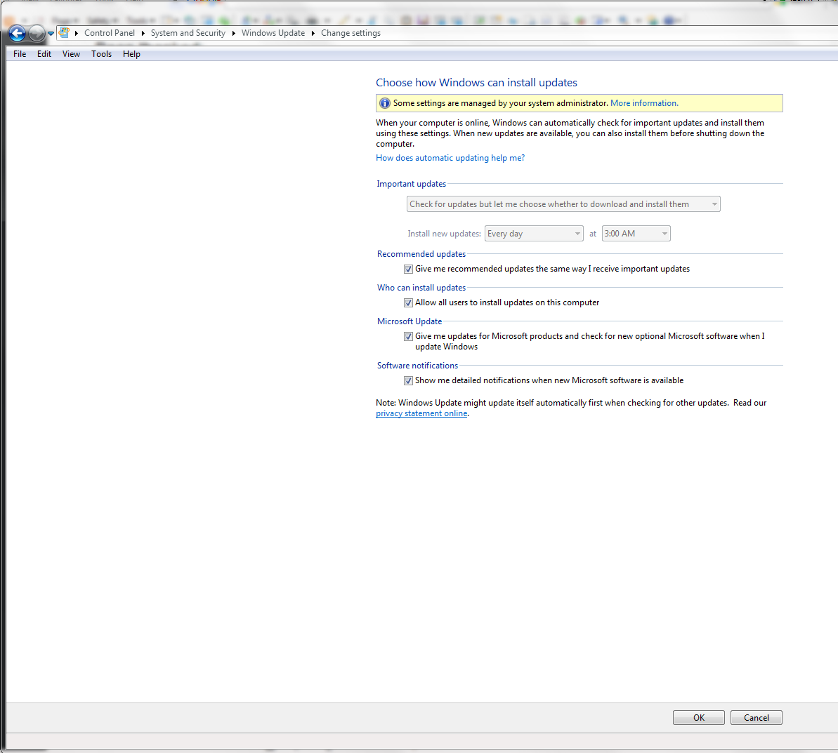

        • #186408
          @walker
          well, sorry, I never saw such absolutely odd stuff like limit of 4 updates in any of win7  WSUS lists including the hidden ones. Moreover I guess it’s just impossible to set such limit or your win7 update center is damaged.
          Anyhow 1st pls check your win7 wsus setting like a pic below. Pls don’t care of a note on ‘some parameters control by admin’. It’s my particular case.
          2018-04-22-Sun_Win7_WSUS_SupposedGoodSettings_Capture
          2nd – the another pic below is just taken from my win7sp1x64ultimate of its current updating status as Dec2017 rollup but KB4099950 PCI 29KB registry patch is installed!
          2018-04-22-Sun_M4300SSDHiddenUpdatesOf13Total_1OfWin103OfTelemetryKB4056894KB4057400KB4074598KB4075211KB4088875KB4088881KB4091290KB4093118KB4093113

          @PKCano:  I have a question relevant to checking the “Add Microsoft Programs Updates” too, when doing the “check for updates”.   It seems that it was recommended, and mine isn’t checked so perhaps that would solve the problem I’m having getting the full listing of “hidden updates”?
          Thank you for any advice you can provide on this subject.  It is very much appreciated, as always.    🙂
          • #186376
            “Updates for other Microsoft Programs” will give you updates for programs like Office, C++, Silverlight, Skype – updates for OTHER programs, NOT Windows updates.
            You may not be seeing past updates because they are not needed. The Rollups and Previews are CUMULATIVE. That means they contain the parts of the previous updates.For example, lets start with Jan:
            Jan 2nd Tues – Jan Rollup contains (Security, non-security, and IE11 parts).
            Jan 3rd Tues – Jan Preview contains (Jan Rollup + Feb non-security)
            Feb 2nd Tues – Feb Rollup contains Feb Preview (Jan Rollup + Feb non-security) + (Feb security & IE!!). Now you have all the parts of the Jan Rollup + all the parts of the Feb Rollup.
            SO, once you have Feb Rollup, you nolonger need Jan Rollup b/c it’s contained in it already. You will no longer see Jan Rollup in Windows Update because you don’t need it anymore. You have all the parts of it in the Feb Rollup.
            Now, that works most of the time – except when MS messes up. But if you can see the latest Update, in this case the April Rollup, you are not missing anything because it contains Jan, Feb, and Mar as well.
