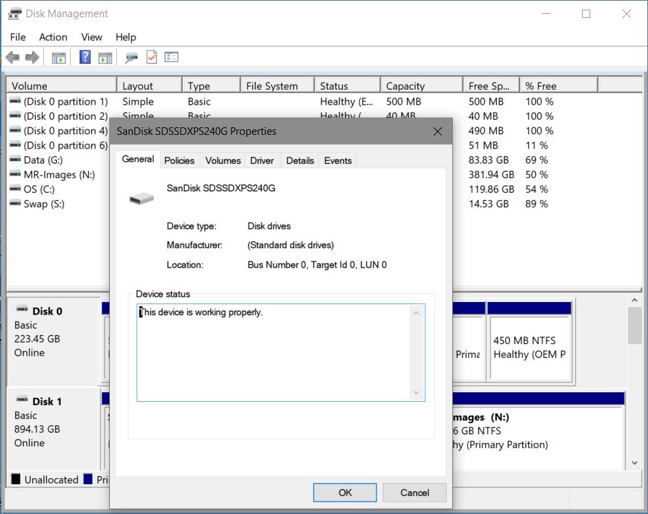

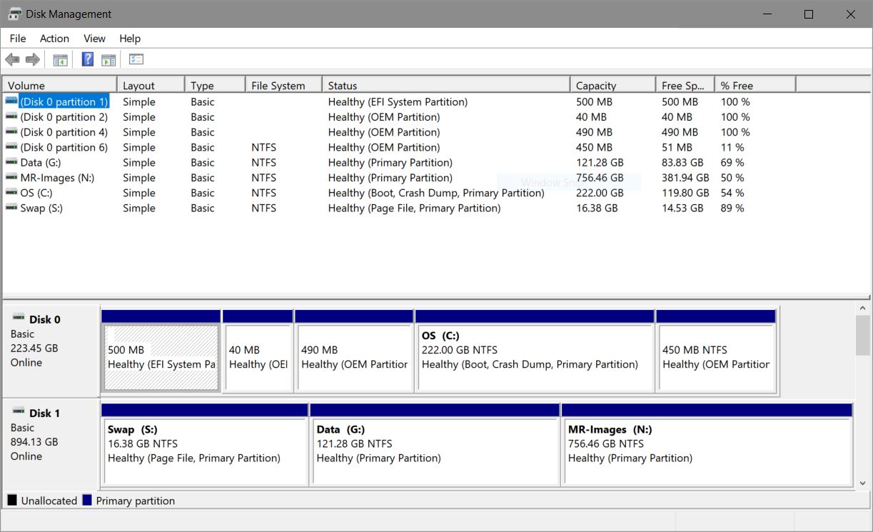

    • #189454
      Disk Management shows my boot drive (I have several drives in my PC) now as Drive 4 when it used to be Drive 0.  But if you look at the Properties for the drive, it shows Location 12 (Bus Number 0, Target Id 0, LUN 0).  None of the other drives show a Location number and  are simply labeled Bus Number 0, Target Id 2, LUN 0 – Bus Number 0, Target Id 3, LUN 0 – Bus Number 0, Target Id 4, LUN 0 – Bus Number 0, Target Id 5, LUN 0.
      So far I haven’t seen any ill effects over this change but it’s still early….
      • #189481
        Tony,
        Interesting. I haven’t noticed any change in my drive designations.
        Disk Management Screen Shot Win 10 1803DiskMgmt1803
        • #189488
          I went into Disk Management to see if it had put back the Recovery partition and sure enough it had.  That’s when I noticed Disk 0 was now Disk 4.  My DM window looks just like yours.  But right click on the grey box to the left of your visual disk layout, where it says Disk 0, Basic, 223.45GB Online and select Properties.
          That’s where I noticed the new “Location” number.
          I know Win10 Updates have mucked with drive identifiers the past.  I use Macrium Reflect and set it to delete the oldest backup when the backup drive gets too full.  After some big updates Macrium doesn’t recognize the oldest backups as coming from the same drive so it leaves them alone.  Come to find out that Windows changed the drive identifier, for reasons unknown.
    • #189491

      For those having issues with a new logical drive (OEM or restore partition) after upgrade, I’ve published an article with workarounds
      Windows 10 V1803 update creates a new OEM Partition
      https://www.borncity.com/win/
      • #189640
        To quote from the article:
        Some people notice after upgrading to Windows 10 April Update, that there is a new partition (recovery partition with Windows PE). Due to the fact, that a drive letter is assigned, the logical drive will be shown in explorer. And Windows 10 starts with annoying notifications, that the disk is full.
      • #189696
        Try the upgrade with switches
        setup.exe /migchoice upgrade /dynamicupdate disable /resizerecoverypartition disable /showoobe full /telemetry disable
        or a variation of it as suitable.
        /resizerecoverypartition disable is the switch of interest here
        /migchoice is undocumented (thanks @abbodi86). The officially documented equivalent with less functionality is /auto

      Just to add misery on the pile, I’ve tried, or rather W10 Pro has tried to Update to 1803 for the last 2 days and its only ended in stop code errors on the blue screen (oops something’s gone wrong) with me having a feeling of de ja vu from the last time.
      After reverting back to the old version 1709 (which it does itself), I have found issues with Chrome and a microsoft.com redirect web page malware which Norton stops only when if you remove the actual page that’s pinned that it doesn’t like.
      Current its telling me it want’s to have another go so I took Woody’s advice and deferred the update for 365 days however wushowhide is not showing the update to hide it, in fact its showing nothing.
      I’ve resorted to removing the WindowsUpgrade directory as well now.
      Just thought I’d share this
    • #190692
      Oh by the way after reverting back to 1709 it took 2 hours last night to get all the USB drives seen again for some unknown reason as they were fine before the upgrade attempt.
