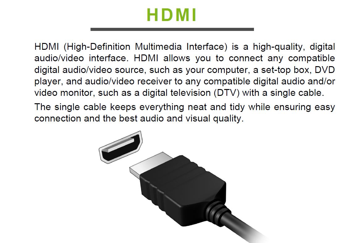

      Check your ACER User Guide: does it address what to expect on audio when HDMI is connected?
      • #2320421
        that only depends on what series and model # of the Acer laptop the OP is using
      • #2320447
        It just explains how a HDMI works and says how good it is. Screenshot attached. “The single cable keep everything neat and tidy while ensuring the best connection and the best audio and video quality.
        Acer-HDMI
