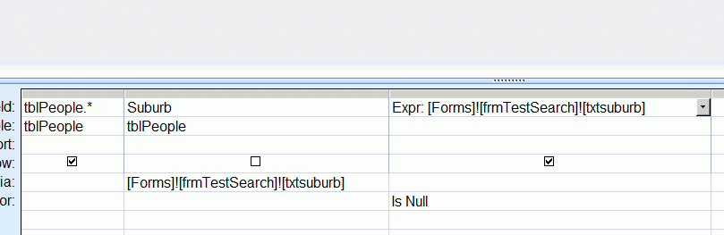

AskWoody LoungerTo be able to Search for one city OR another you need two text boxes.
The SQL for the query looks like this:
Code:SELECT tblPeople.* FROM tblPeople WHERE (((tblPeople.Suburb)=[Forms]![frmTestSearch]![txtsuburb]));
For an OR query it needs to look like this
Code:SELECT tblPeople.* FROM tblPeople WHERE (((tblPeople.Suburb)=[Forms]![frmTestSearch]![txtsuburb1]) or ((tblPeople.Suburb)=[Forms]![frmTestSearch]![txtsuburb2])) ;
One option is a multiselect list box, listing the towns you have. But this requires VBA code. It can’t be done with a simple query.
You can tell the query to treat an empty text box to mean All Cities.
Code:SELECT tblPeople.* FROM tblPeople WHERE (((tblPeople.Suburb)=[Forms]![frmTestSearch]![txtsuburb])) or OR ((([Forms]![frmTestSearch]![txtsuburb]) Is Null));
That looks like this in the query grid.
30615-CitiesqueryReally flexible searching generally requires using VBA to write a Where clause

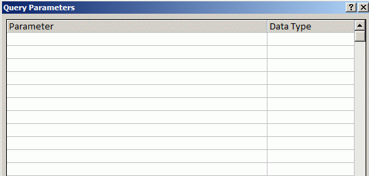

AskWoody LoungerDoes your export code use DAO?
Have you explicitly declared the parameters in the query Parameters Dialog?
30608-queryParametersYou don’t always need to do this, but if things are not working in can help.
