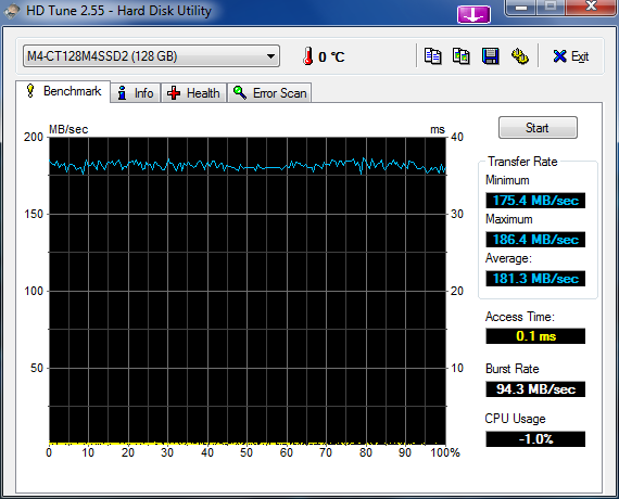

AskWoody LoungerYesterday (check out my new specs in my sig), I installed a new 128GB Crucial M4 SSD in my MSI FX603 notebook w/no bad issues to report. The really great thing was, I done it with Free software, Easeus Todo Backup 4.5.
http://www.todo-backup.com/products/home/download.htm
The really great thing about restoring with this backup program, is the option to “Optimize for SSD”. The restore took longer due to this, but when all was done, I didn’t even need my Windows 7 Pro x64 install disk to do a repair with, it fired right up. Had to reboot for new hardware install, then ran the WEI (as suggested) to make sure that the SSD’s features were turned on.
It evidently did create the 1MB blank space in front, as my recovery partition was reported as being 9.99GB (10239MB), rather than 10GB (10240MB), as it always done when restoring. Anyway, even with the SATA 2 bottleneck, the new SSD still exceeded my expectations. Never have I had this type of performance with a mechanical HDD, even the 1TB WD Caviar Black, running at 7200rpm & a 64MB cache.
31080-HDTune_Benchmark_M4-CT128M4SSD231081-HDTune_Info_M4-CT128M4SSD2
This is also my 1st ever SSD, & I doubt that I’ll be looking back in the mirror, except for storage. One other thing, I bought this SSD direct from Crucial, it was optimized for my make & model of notebook. No firmware update was required, it was done prior to shipment. I had done business with Crucial before, they recommended a RAM upgrade for the PC that I’m on now. Not only was the RAM increased to 4GB (it’s max), but it was faster RAM than what HP provided. Normally, I buy most of my hardware/software from Newegg, but with 5 different 128GB M4’s to choose from, neither of which was recommended for my notebook, I just felt more comfortable with Crucial’s 100% compatibility guarantee (return shipping, if required, on their dime).
Needless to say, I’m very happy with my first SSD.
