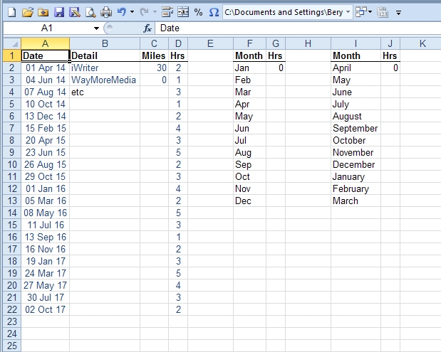

AskWoody LoungerOkay, thanks again RG and Zeddy – I’ve got something usable now that’s *almost* exactly what I wanted! I discovered that I don’t need to add an extra column to the results table, if I get the list of month labels by entering them as dates (doesn’t matter what the date is as long as the month is right in each case) and formatting them as “mmmm” – that is, I put “1 1 1” in the cell for January (without the quotes, of course), “2 2 2” for February, etc. Having done that, Zeddy’s formula can be slightly modified to:
=SUMIF($E:$E,MONTH(L2),$D:$D)
And it works perfectly. I still can’t work out how to get XL to pick the month out of the date in column A rather than have to add column E, and have therefore had to add that column but hidden so it doesn’t interfere with the layout of the form.
One other thing to note, if you want to use this, or a variation of it – the extra (hidden) column can’t just be “=Month(A1)” all the way down as for some reason XL reads a blank cell as “1”, which would throw all the January figures, so I ended up using “=if(A1″”,Month(A1),””)”. That’s if, as I am, you’re setting up a ‘master’ that will get filled in over the year, and don’t know exactly how many rows it’ll be yet, not to mention will be blanking and reusing it for next year. I’ve assumed a max of 200 and filled in my formalae down that far.
Once again, many thanks, everyone – although if anyone does know how to get XL to extract the month from the date without having to use an extra column, please do say so! That would make it just perfect!

AskWoody LoungerHi RG, thanks for this but I must admit I was hoping for something that didn’t include the year – and my layout is per the attached, sorry should have done that in the first place. I can live with the shortened versions of the months (Jan, Feb, etc) in both original and results but would really prefer to have shortened ones in original and full length in results – that’s why I wanted something that had XL recognising that they were months!
In fact I have just tried to apply your suggestion but it didn’t work – I’ve a feeling it relies on the fact that your months are displayed as numbers, and of course mine aren’t.
Thanks for the suggestion, though.
