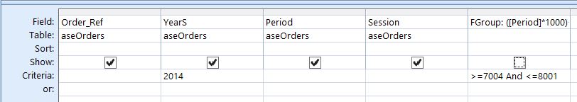

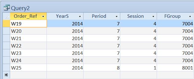

AskWoody LoungerAlan,
Using math is a very good idea and the only way I think you’ll solve this problem. Here’s my take on that approach.
SQL:Code:SELECT aseOrders.Order_Ref, aseOrders.YearS, aseOrders.Period, aseOrders.Session FROM aseOrders WHERE (((aseOrders.YearS)=2014) AND ((([Period]*1000)+[Session])>=7004 And (([Period]*1000)+[Session])<=8001));
Access Query Design:
38390-aseQDJPG
Results:
38391-aseResults
Note: The results show the calculated field for reference only as you'll note both the SQL and Query Design omit that field!Note2: I multiplied the Period by 1000 before adding in the Session to avoid any rollover results since I didn't know how many Periods or Sessions you had.
that certainly helps a lot thanks! Very much appreciated :cheers:
WSase001
AskWoody LoungerThanks RG
partial table for illustrative purposes is:
Order_Ref YearS Period Session
W15 2014 7 1
W16 2014 7 1
W17 2014 7 1
W18 2014 7 1
W19 2014 7 4
W20 2014 7 4
W21 2014 7 4
W22 2014 7 4
W23 2014 7 4
W24 2014 7 4
W25 2014 8 1Using the parameters of greater than/= period 7 session 1 and less than/= period 8 session 1
should return all lines of data, which it does
But if I want to see only those records where the parameters are greater than/= period 7 session 4 and less than/= period 8 session 1
I get nil returns when actually I am expecting to see Order_refs W19 to W25 incl.Hope that helps.
I am considering using math to make the period 7 session 1 into say 71 and use that ?
thanks
Alan -
