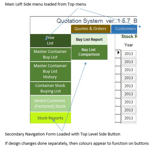

AskWoody LoungerJanuary 25, 2014 at 7:12 am in reply to: Access 2013 Navigation Forms On Navigation Forms buttons lose colour #1435773OK, to follow this up, with a possible solution, that is working for me anyway…
I tried a different slant on design changes, which I should have thought of at the start.
I changed the design of the second level (subform) navigation form, on it’s own.
Tested it on its own, and it worked just fineThen tested it via the top level Navigation form, and it was fine.
It appears that this may only be an issue, when you attempt to change the design of the sub navigation form, from the design screen of the main navigation form.
Maybe it will eventually get fixed, who know.
See attached image for example with working buttons.
Even when the formatting went wrong, the forms worked ok.
You just couldn’t see the text on the buttons… -
