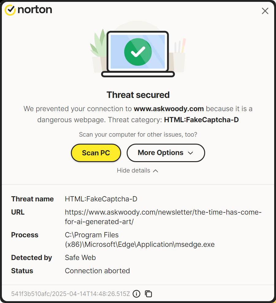

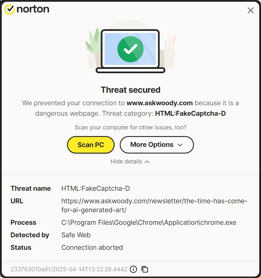

AskWoody PlusUnfortunately, Firefox is not on the machine running Norton 360. As Susan indicated, it seems that Norton is ‘seeing’ the fake “Verification Steps” image as part of something malicious.

AskWoody PlusHi Susan. I have Norton 360 installed on one of my machines (Windows 11 23H2 fully patched). When I browse to the latest April 14 Newsletter, I get the popup message below. This is the first time I’ve seen this on Askwoody.
Is it possible that this is being triggered by Brian Livingston’s article, as the Norton message refers to FakeCaptcha-D?
Can I assume that this is Norton being overly protective? Wasn’t sure if this was the best place to post this, so my apologies as this is not quite thread related.

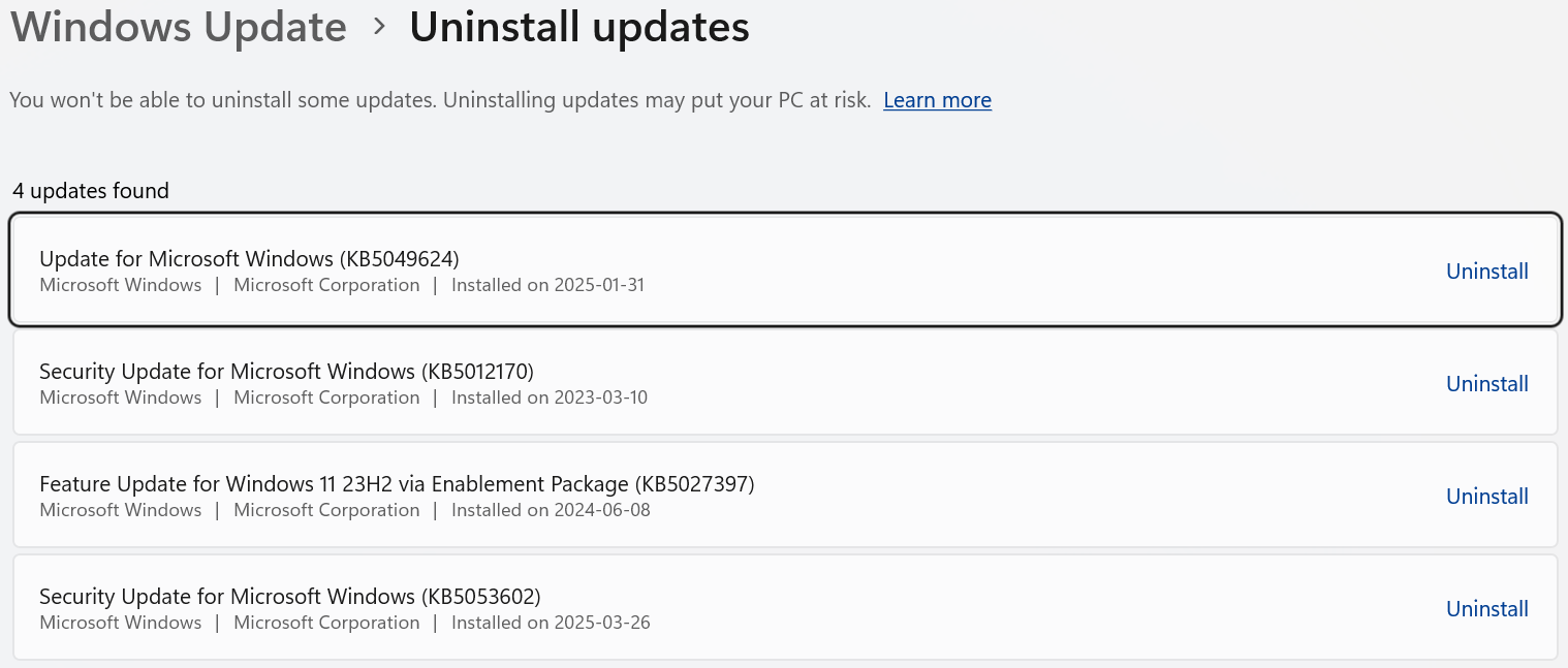

AskWoody PlusNo. I use InControl to keep Windows 11 at 23H2, and had Windows Update paused. When I unpaused Windows Update yesterday, KB5053602 downloaded and installed (seemingly without incident – only a single reboot required).
Interestingly, I did download and manually install the Windows 11 23H2 Enablement Package last June (as was recommended). That may explain why KB5027397 did not show up under the Feature Updates listing.

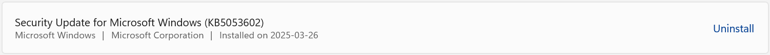

AskWoody PlusThanks for your feedback – what you’re seeing is what I was expecting.
I’m running Windows 11 Home Version 23H2 (OS Build 22631.5039). Clicking on “View installed updates” in Control Panel takes me back to the Settings App.
There are four Uninstallable Updates listed in Update History, as per the following:
The Windows 11 23H2 Enablement Package (KB5027397) also never showed up under the Feature Updates listing, even though it successfully installed. The other two Uninstallable Updates (KB5012170 and KB5049624) are found under the Quality Updates list. Other updates recently installed have showed up in the Update History listing.
As everything appears to be running without errors, I am inclined to call it a day, and see what happens next month, and when I eventually make the transition to Windows 11 24H2 (once Susan gives us the green light).

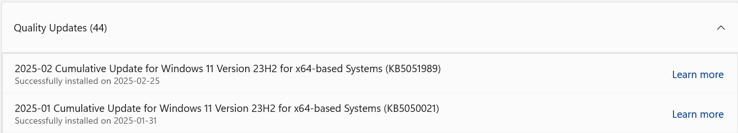

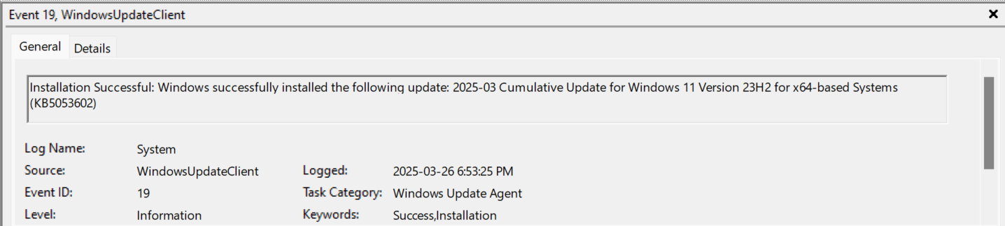

AskWoody PlusSuccessfully installed KB5053602, 2025-03 Cumulative Update for Windows 11 Version 23H2 for x64-based Systems, according to Event Viewer log and Uninstall Updates listing, as per the following screen captures:
Strangely, KB5053602 does not appear under the Quality Updates list of Update History, as previous Monthly Cumulative Updates did (see the following screen capture):
dism /online /cleanup-image /scanhealth indicated “No component store corruption detected”. sfc /scannow indicated “Windows Resource Protection did not find any integrity violations.”
Anyone else seeing this with KB5053602 (for the first time)?
