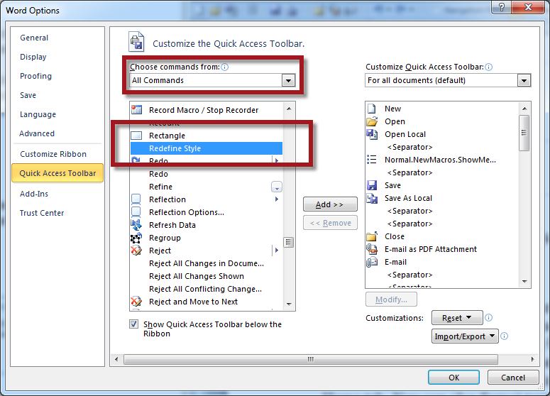

AskWoody PlusHey Mike,
There’s no coding required. Yes, I am referring to the Quick Access Toolbar. Click File>Options>Quick Access Toolbar (or get there by right-clicking the QAT or Ribbon and choosing “Customize Quick Access Toolbar”).
Once there, choose All Commands in the drop down under “Choose commands from:” and scroll down to “Redefine Style”. Add it to your QAT. I’ve included a screenshot from Word 2010, but it’s the same in 2013.
I’m afraid I’m not familiar with the Win 10 / Office 2013 macro processing rules (perhaps someone else is and can jump in), but if you describe what’s going wrong I may be able to help. (I’ve run Word 2010, 2013, and 2016 on a virtual pc with W10 and not noticed any particular issues with macros other than deprecated features.)
Best, Kim
