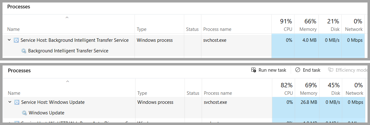

AskWoody PlusMarch 13, 2025 at 10:49 am #2755536Using WuMgr I hid a cumulative preview, but tried to install KB2267602 & KB5053602.I’ve never had a WuMgr update/install fail before. The log just kept scrolling & scrolling, for 3 minutes, as it was populated (see attached video). Additionally, I was getting an Install fail on KB2267602 on the screenshot below, but it installed fine today. KB5053602 is still failing today.I am running InCtrl & holding at 11, 23H2. I’ve noticed that the Setting, Windows Update button not to respond to a click. Could that be due to running InCtrl?Viewing 16 reply threadsAuthorReplies-

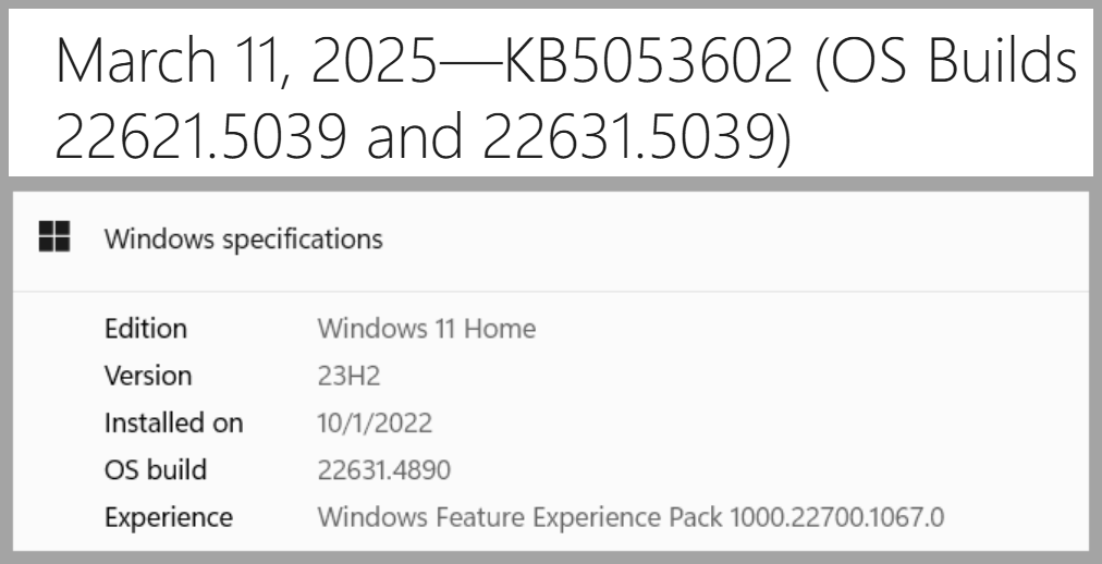

I checked this out before posting, https://support.microsoft.com/en-us/topic/march-11-2025-kb5053602-os-builds-22621-5039-and-22631-5039-19284fef-ba57-440b-a027-2d5eeecb73fa
My version info. is below,

Pen and touch Touch support with 10 touch pointsEdition Windows 11 Home
Version 23H2
Installed on 10/1/2022
OS build 22631.4890
Experience Windows Feature Experience Pack 1000.22700.1067.01 user thanked author for this post.

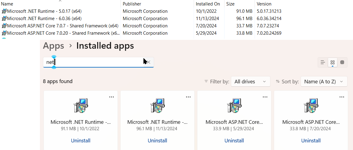

AskWoody PlusApril 10, 2025 at 6:34 pm #2762157You have .NET 8. Why, I don’t know, but you must have installed it. I’d patch after backing up.
Who cares about the hidden list? Hidden = do not install and there should only ever be drivers, firmware and previews in there.
No, not yet, but an application I use suggests it….
