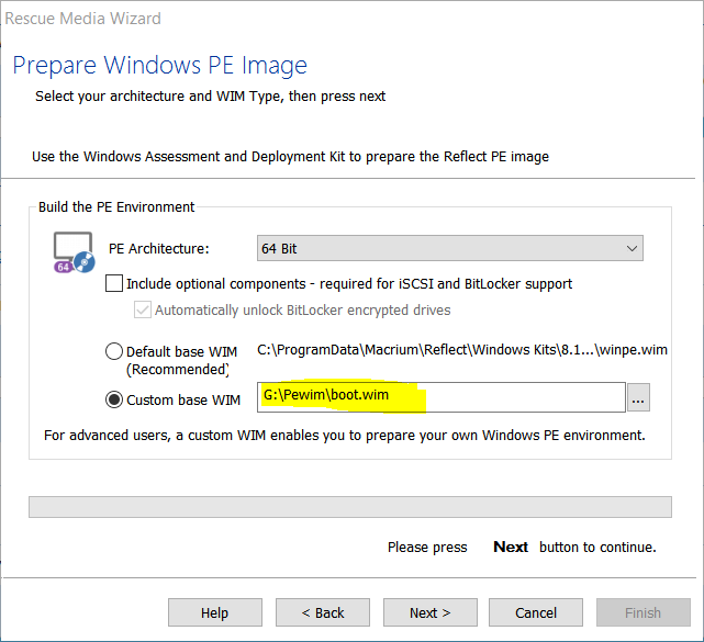

      Hey Y’all,
      Hope you didn’t think I’d forgotten about this but it took me a while to track everyting down.
      So here’s the code to create a Custom WIM (Windows Image File) for Windows PE.
      I’ve tried to make this code as easy to understand and more importantly customize what is included on the Boot Media.
      You’ll find 2 array variables one for PowerShell Programs and one for Utility Programs. You can just modify the contents of these variables to include the PowerShell scripts and your favorite Utility programs. Note that I’ve included BASE directories in the $CIArgs variables and then just fill out the paths in the arrays. So just modify as appropriate for the computer you are using to create the image.
      Assumptions:
        [*]You have already installed the Windows Assessment and Deployment Kit on your machine in the correct BITNESS!
        [*]This program does NOT create your bootable media! I’ll probably create that program shortly but I’ve been using Macrium Reflect to create its bootable media using the custom WIM created by this program as a base so I have a full emeregency bootable disk on a single bootable media.
        44352-MRCustomWIM
        [*]You are familiar enough with PowerShell to create your own PS code or download utilities from the internet.
        [*]The utilities (programs) you load into the Utilities directory are the same BITNESS as your Windows PE installation. WOW (Windows on Windows 64) is NOT supported in the 64 bit installation! If you try to run a 32 bit program on WinPE 64Bit you’ll get this message: ”The subsystem needed to support the image type is not present.”

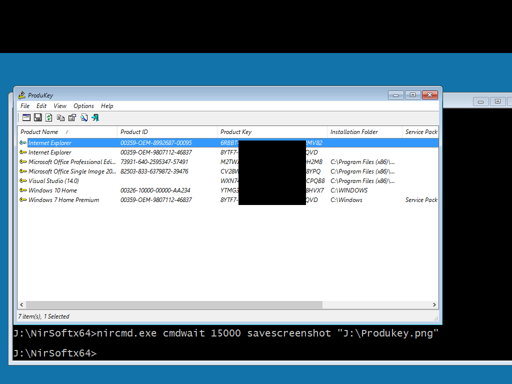

      Usage:
      Once booted into this disk you get the Macrium Reflect user interface which has the Icon on the taskbar for a Command Window.
      From the command window you can:
        [*]Run the utilities you loaded on the image, Ex:
        x:UsersUtilitiesHWiNFO64.exe
        [*]Start PowerShell Ex:
        WindowsPowershellV1.0powershell.exe
        Note: navigation of the above command starts from the active directory which is x:WindowsSystem32
        [*]Once PowerShell is started (if you have loaded a profile pointing to your scripts) you can start your PS Scripts as follows:
        .scriptname.ps1
      Here’s the Program: 44351-CMsWinPESetup

    • #1563076
      Hey Y’all,
      I’m back again…groan!
      As promised in post #8 I’ve now have running code that will create a WinPE boot USB key. If the code is created on a machine running UEFI/Secure Boot the resulting USB Key will boot on both UEFI Secure boot & Legacy hardware!

      $CIArgs = @{Path        = "[COLOR="#0000FF"]G:Pewimboot.wim[/COLOR]"
                  Destination = "$WinPETempMediaSourcesboot.wim"}
      Copy-Item @CIArgs
      $WinPEKey = "$OSDrive" + ":"
      $CIArgs = @{Path        = "$WinPETempMedia*"
                  Destination = "$WinPEKey"
                  Recurse     = $True
                  Force       = $True}
      Copy-Item @CIArgs
      & "$($env:windir)system32bootsect.exe" /nt60 "$WinPEKey"
      Make sure you change the items in BLUE to match those in the CMsWinPESetup.ps1 program!

      FYI: I’ve been messing around with adding programs to the custom image and from my testing the 64Bit NirSoft utilities work and with the use of the NirCmd.exe program you can even take screenshots in the WinPE environment. Note: I did write the shots to a second USB key which BTW is where I initially tested the utilities before loading them into the image.
      44421-Produkey-From-WinPE
      As you can see this can be handy if you are trying to get software keys from an unbootable C: drive via ProduKey’s File->Select Source->2nd option button. You can see the two versions of Windows & Office from my dual boot laptop.
