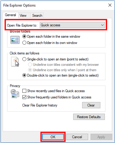

      Have you by any chance disabled Quick Access, perhaps from this post?
      If so, try the following:
      1. Right-click on the Start button and select Run.
      2. When the Run dialog appears, copy/paste explorer shell:::{6DFD7C5C-2451-11d3-A299-00C04F8EF6AF} into the text entry box then click on the OK button.
      3. When the Folder Options dialog appears, change the Open File Explorer to: dropdown from the default Quick Access to This PC then click on the Apply then OK buttons.
      46580-folder_options
      Click to enlarge

    • #1590112
      An issue with Quick Access, like removing it from the Navigation Pane, results in the exact symptoms you described, hence my question in post #4.
      You would have been able to drill down through folders because Quick Access doesn’t add them to Frequent Folders until you’re been to the same folder several times, i.e. frequently. Similarly, you wouldn’t have a problem with a file if it was already in the Recent Files list because Quick Access wouldn’t have anything to do.
      However, if you had Quick Access disabled but still had the tick in the Show recently used files in Quick Access checkbox (Folder Options > Privacy) then you would get an error when you tried to open a file that wasn’t already in the Recent Files list due to the conflicting conditions. Similarly, if you removed Quick Access from the Navigation Pane but didn’t change the default view (in Folder Options) from Quick Access to This PC then you would get an error.
      The errors would happen whether you used a file on the desktop, within a folder or even within an Open/Save dialog in a program because Quick Access has replaced Favourites in all Navigation Panes.
      Have a look at this post, particularly the second link, i.e. How to Add or Remove Quick access in Navigation Pane of File Explorer in Windows 10. If you scroll down to the section labelled 8. To Remove Quick access from Navigation Pane I suspect you’ll recognise the screenshot of the error dialog.
      Now, you may not have disabled Quick Access or removed it from the Navigation Pane yourself but IMO the symptoms point to an issue with Quick Access.
