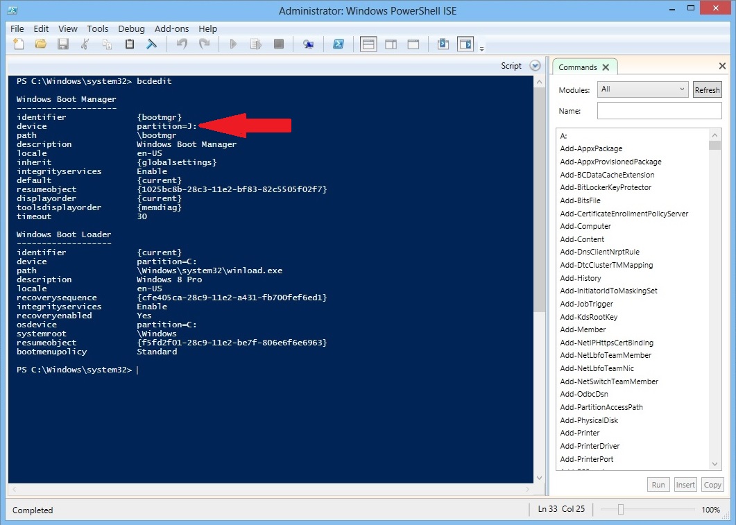

      1 Is there a way to edit this drive to make it just a “primary partition”, as opposed to a “system, active, primary partition”?
      2 Is there a safe way to move these boot files back to the primary OS drive without interrupting
      the boot process into Windows 8 the next time I restart?
      32321-Untitled1
      BCDEdit invoked through Windows PowerShell ISE
      3 How did I manage to get the Boot Manager on this drive in the first place?

      OK, I managed to fixed my bootmgr issue;
      I used Diskpart in an elevated command prompt to create a MBR boot item on the primary C drive:
      (where it should be)
      bcdboot c:Windows /s c: /l en-us
      I then used diskpart to inactivate the drive the bootmgr files were originally placed on:
      (I only need one active primary as I don’t dual boot)
      type diskpart, enter
      type list disk, enter
      type select disk #, where # is the disk that has the partition to unmark, enter
      type list partition, enter
      Type select partition #, where # is the partition you want to unmark, enter.
      type inactive, enter.
      type exit, enter.
      I then rebooted and manually deleted the bootmgr files from the drive they had originally been on.
      Then reimaged the drive and deleted old images where bootmgr were missing from primary C drive.
      Problem solved. Sorry, I was under the impression that this was specifically a Windows 8 issue when in fact this can happen in Windows 7
      and other Windows versions as well. Too many hard drives I guess. With a total of 8 drives installed on this machine something is bound to get messed up.
      32322-Untitled2
      BCDEdit in Windows PowerShell ISE shows everything where it should be 🙂
