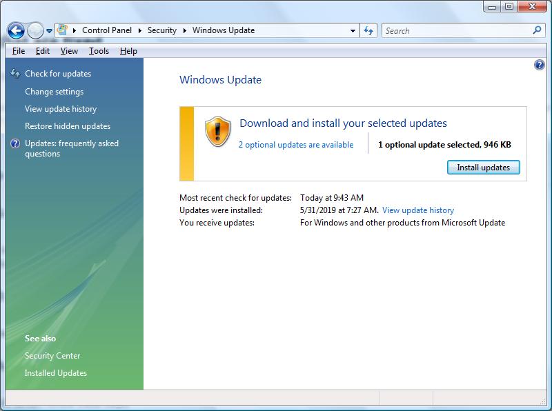

      As of this writing, my Vista system is still connecting to the Windows Update server:
      Vista-updates-still-available
