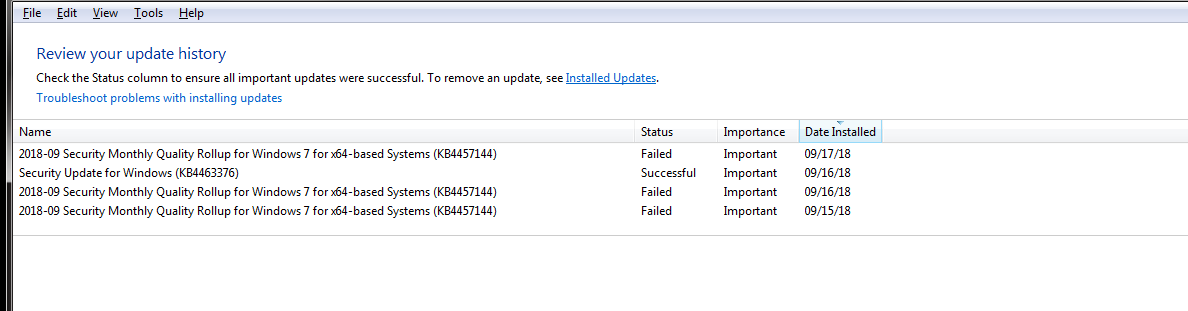

AskWoody LoungerSeptember 17, 2018 at 4:13 pm #218041Woody my apologies I thought we were talking the same thing. I have Windows 7 Ultimate x64.
The failing rollup is KB4457144 with error code 80073701.
I successfully installed KB4463376 in my debugging.
The last successful automatic update was KB4457044.I have attached the relevant logs screen shots.
I hope this is helps. It is driving me crazy. Thank you
Kevin
AskWoody MVPSeptember 17, 2018 at 4:42 pm #218048Ok, Wait until Woody’s MS-DEFCON level is switched to 3 or greater (top of the page) before installing anything as we are currently at MS-DEFCON 2 ‘Patch reliability is unclear. Unless you have an immediate, pressing need to install a specific patch, don’t do it.’
You need kb3177467 Service Stack Update installed prior to installing kb4457144 which is available here: https://www.catalog.update.microsoft.com/Search.aspx?q=3177467You have already successfully installed the update fix for IE11 KB4463376 and should be ok for now until the MS-DEFCON level changes.
