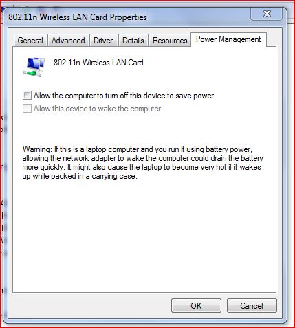

      • #1342984
        31583-Lam-card-Property31584-Realtek32096
        Thanks. I checked the properties of the network adapters, power management and I attached an image of what it is.
        I checked the Task Manager… I cannot see any scheduled tasks for that time, unless the time is hidden somewhere in the Task Manager, because I cannot see any schedule anywhere.
        Please, forgive my ignorance, I am far to be familiar with all those things in my computer; it is the reason why I am posting here, and try not to look too dumb.:rolleyes:
    • #1342985
      I suggest you check the option to Allow the computer to turn off this device to save power, for both adapters and uncheck the option Allow the device to wake the computer. The latter is the one most relevant to this issue.
    • #1342987
      I have done as you suggested. The proof will be in the pudding tonight as I put it to sleep. Thank you very much, I should have seen that but anyway, I hope this will fix the problem once a for all.
      I cannot thank you enough for this was upsetting my evenings watching television.:)
