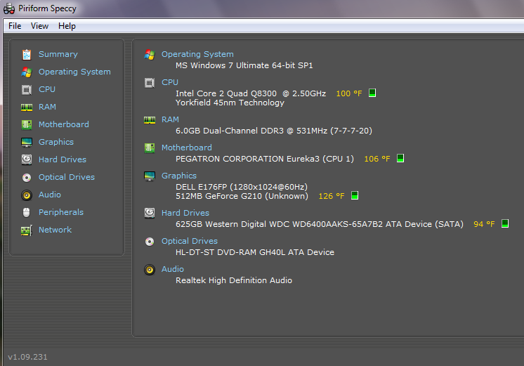

      SP-1 installed without a problem. However, I made sure that I made an image first with Acronis Home 2011 – just in case. Some specs of my system follow:
      27505-Speccy

            Success. It took between 2 1/2 and 3 hours (downloaded the Service Pack to the hard drive and installed from there), but no hangups. Configuring at shutdown and reboot was significantly longer than for my desktop, but again, no hiccups, just lots of hard drive activity. I’m running MSE and did not disable it, but it caused no problems.
            It lost the printer, a network printer, but when I clicked on “Add a device”, it had no trouble finding it and installing the drivers. Not bad for an old laptop (8 years) that’s not supposed to be able to run Windows 7 in the first place.
            Pretty impressive for a machine that age. BTW, it’ll probably be noticably slower than normal for a while. Windows 7 has to rebuild prefetch cache. Defrag has to run. If you index your Windows install folder and/or Program Files then they must be reindexed. After you are OK with SP1, see Windows 7 SP1 Disk Cleanup Tool – Windows 7 Forums to reclaim quite a bit of disk space.
            Joe
