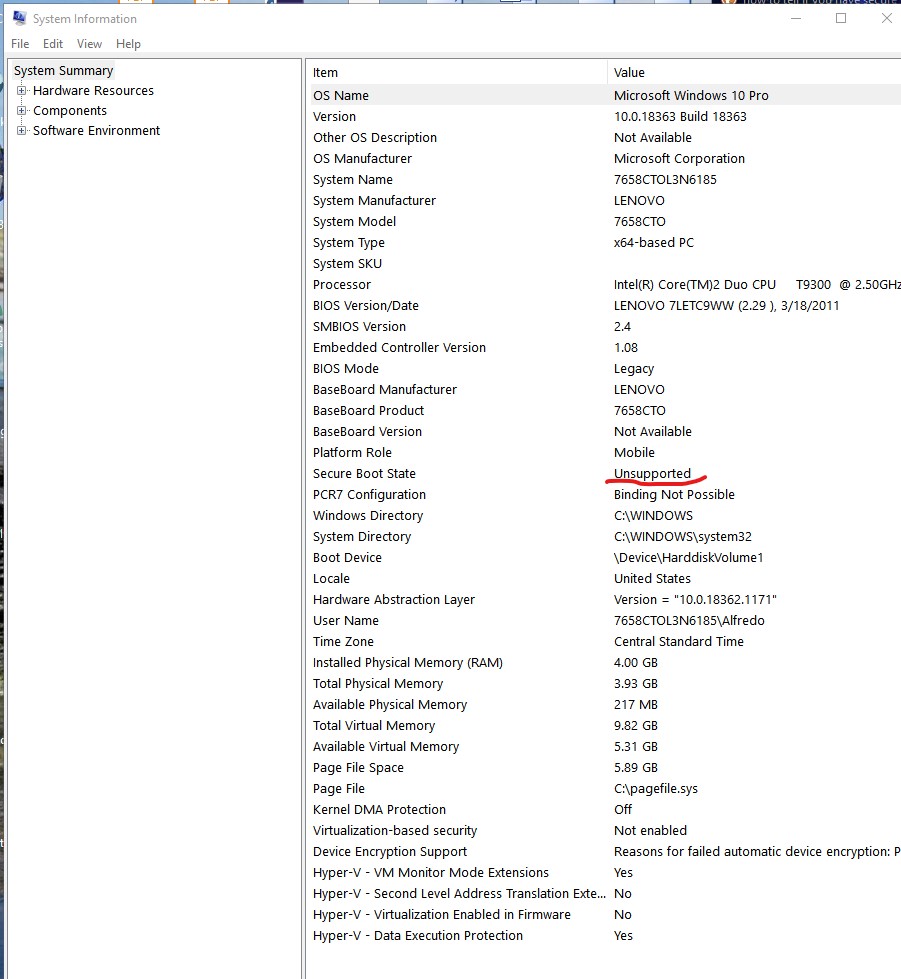

        • #2341620
          It looks like Secure Boot is Unsupported on this PC.
          SecureBootStateUnsupported
          So Security update for Secure Boot DBX KB4535680 was probably irrelevant anyway.
          Thank you.
