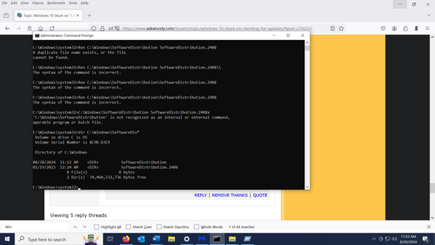

    • #2700332
      If you get that, just keep going with the last set of commands above. You will start/restart the update service after renaming the SoftwareDistribution folder.
      PK:  Thanks for your response.  I think I might have run into a problem on the step for renaming the distribution folder.  It responded by saying “A duplicate file name exists or the file cannot be found”.  I did an electronic search of my C-Drive and  I do find a number of folders with the name SoftwareDistribution.2408 as part of the name.  I’ve attached a screenshot to show you Screenshot-Aug-29-2024-2.    Please advise me on what I should do next.
      • This reply was modified 9 months ago by L95.
      • #2700357
        Please don’t put screenshots in documents and then post them, save the shot as a PNG and then attach the PNG. This means we don’t have to download a DOC, open it and then clean up afterwards.
        L95
    • #2700358
      Rename the folder to something else, e.g.
      Ren C:\Windows\SoftwareDistribution SoftwareDistribution.2408x
      To see if the folder still exists / has been renamed, type this in your admin Command Prompt:
      dir C:\Windows\SoftwareDis*
      L95
      • #2700424

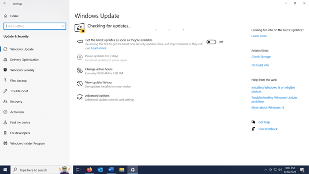

          PK:  Thanks for your response.  I closed out of the command prompt window and started fresh with a new command prompt and then followed all the instructions between **** and  ****,  as you recommended.  Then I restarted the computer,  and here are my answers to your questions:
          (1) Is Windows Update still stuck on searching for updates?   Yes, it’s been stuck for almost an hour since I restarted the computer.
          (2) Is “Resume Updates” available as an option?   No.
          (3) Is  “Search for updates” available as an option?  Not as far as I can tell.  Here is a picture,  and I don’t see anything there that says “Search for updates”.  You can see at the top it says “Checking for updates”,  but that just means that a search for updates has already started.   PNG-Aug-30-2024-2
          I hope that answers your questions.  Please advise me on what I should try next.

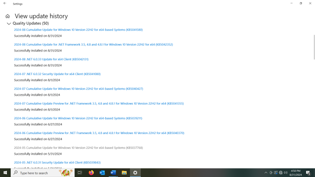

    • #2700617
      That probably won’t make any difference.
      PK:  Thanks for your response.  I decided to go ahead and try the “unplug from wall socket” technique because you didn’t indicate it would cause any harm to try it.  And it looks like the technique solved the problem.  Once I restarted the computer,  the “Resume Updates” button re-appeared,  and when I clicked on “Resume Updates”,  the updates for August downloaded and installed successfully.  They’re shown as the first three line items in the picture below.  Before accomplishing the technique,  I first made sure to save my files and do a backup, so as to prevent losing any data.  The shut-down technique was a little tricky because when I  clicked on “Shut Down”,  it would shut down only momentarily and then immediately restart again,  without giving me a chance to unplug from the wall socket.  So I read an article about this,  and the article recommended to disable the “Fast Startup” feature of Windows 10 by going into “Power Options” and removing the check-mark that is beside the setting called “Turn on Fast Startup”.  However,  in my case,  there was no check-mark in that box because I had removed the check-mark several months ago because I preferred not to use this feature.  Can you explain why it was still doing a fast startup even though there was no check-mark in that box?  Anyway,  the way I overcame this was after clicking “Shut Down”,  a message appears that says “Task Host Window is stopping background tasks”,   but then below that there’s a button that says “Shut down anyway”.   So I clicked on “Shut down anyway”,  and this time it actually shut down permanently without doing a restart.  After that, I unplugged the computer from the wall socket and let it sit that way for 15 minutes,  and then plugged it back in and restarted the computer.  And once it restarted,  the “Resume Updates” became available to me,  and then I clicked on “Resume Updates”  and it successfully installed the August Windows Updates as shown in the picture below.   Thanks very much to everyone who provided advice in this forum topic,  but it looks like this simpler technique worked,  and I would appreciate any further comments if anyone thinks it may have been wrong or harmful to fix the problem this way.  PNG-Aug-31-2024-3
      • #2700619
        If it worked for you – well, it worked.
        If it happens again next Patch Tuesday, then maybe there is something else causing it.
        Glad you got it fixed.
