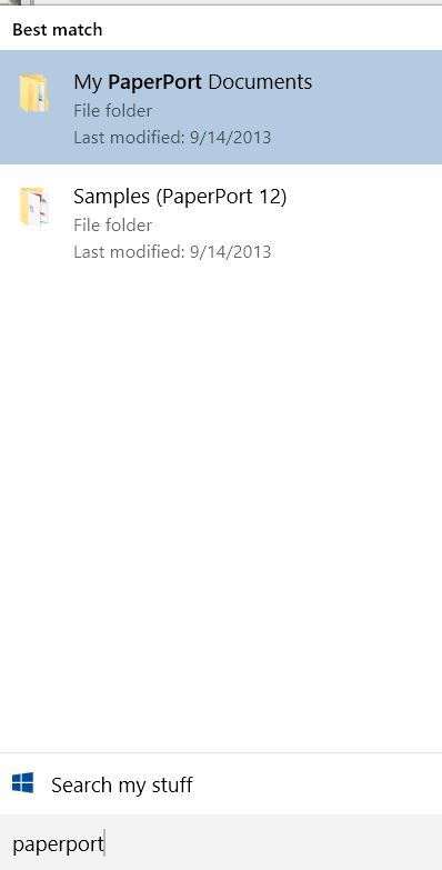

      I am having the same problem. Some program files (.exe) are not being found by Windows search. Help files, folders, zip files with the same name do show up.
      I have rebuilt the index, checked the file types and what folders are being indexed. For example, paperport (C:Program Files (x86)NuancePaperPortPaprPort.exe) returns
      42379-Capture
      Also, searches for Autoruns, process explorer and processs monitor do not return the correct results.
      • #1534031
        All I can say is destroy the index as I noted above and force a total rebuild from scratch. That is what I finally had to do.
