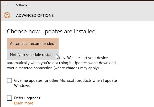

      • #1575551
        I do a system image every week and did an extra one before attempting the AU. The AU worked without any issues on my Dell. Just the HP that’s presenting a problem. I’ll wait for a later upgrade, I think. Where did you check “Defer Upgrades”? I haven’t seen that option.
    • #1575555
      Settings>updates and security>windows update>advanced options
      45382-defer-upgrades
    • #1575557
      Thanks, but I don’t have the PRO version, so I don’t believe I can use this.
