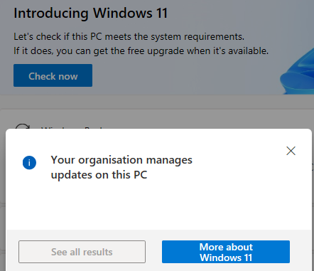

      I have yet to try to install 24H2, but following Susan B’s comment the other week, I thought I would try the “Installation Assistant”  idea, to be sure, although I am already on 23H2 without trouble.
      I get
      Screenshot-2025-04-25-125412
      So I get the PC Health app and run that:
      Screenshot-2025-04-25-124721
      The question is who is my organization?  This machine is mine alone, and I am admin.
      Could the Xanatos Update Manager be responsible?  How would I check?  Can it be disabled temporarily without allowing automatic updates to kick in?
      Is it Gibson’s Incontrol app that leads to that condition? (I have control …)
      I am loth to try any experiments without some clue.
      If even one Group Policy (or its registry equivalent) is set other that its “default value“, Windows will display that warning.
      This happens because Microsoft “assumes” only organizations ever use Group Policy settings.
      And yes, if you’re using InControl, it sets 6 different values in the registry; some of which are the same values modified by certain Group Policy settings.
        See the W10 Grp Policy vs InControl thread for details.

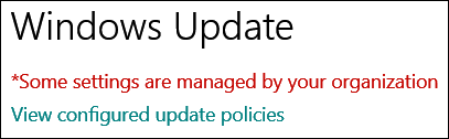

          It is only a warning (i.e. it can be “dismissed” by clicking the X in the top right corner. )
          BTW, you’ll also see a warning at the top of the Windows Update screen if you have a Group Policy (or its registry equivalent) set.
          OMwarning
          However, there’s a View configured update policies link right below that one to display the settings that cause the warning to appear.
