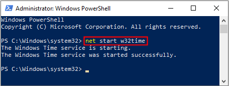

      It’s perhaps best to confirm whether the Windows Time service is working (‘cos it doesn’t run all the time nor does it synchronise at frequent intervals). Try this:
      1. *Right*-click on Start and choose Windows PowerShell (Admin) [or Command Prompt (Admin)… either will do] then accept the User Account Control prompt.
      2. When the PowerShell or Commandline window appears, enter net start w32time at the prompt. This will try to start the Windows Time service manually and you should see the following:

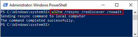

      3. Next, enter w32tm /resync /rediscover /nowait (and make a note of the time you do this). This tells the Windows Time service to check the network settings for the the NTP (network time protocol), poll the configured time source(s) and synchronise the time immediately. You should see the following:

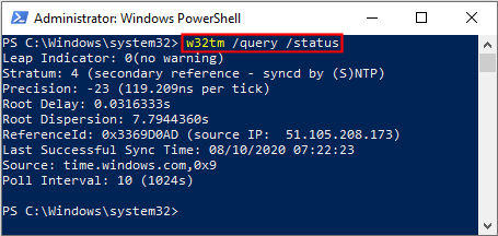

      4. Next, to check everything is working, enter w32tm /query /status. If all has gone well then you should see something like this:
      time03-status
      ‘Last Successful Sync Time’ should show the time milliseconds after you last pressed the Return/Enter key; ‘Source’ shows the time source (the default is time.windows.com) and ‘source IP’ shows the IP address of the time source.

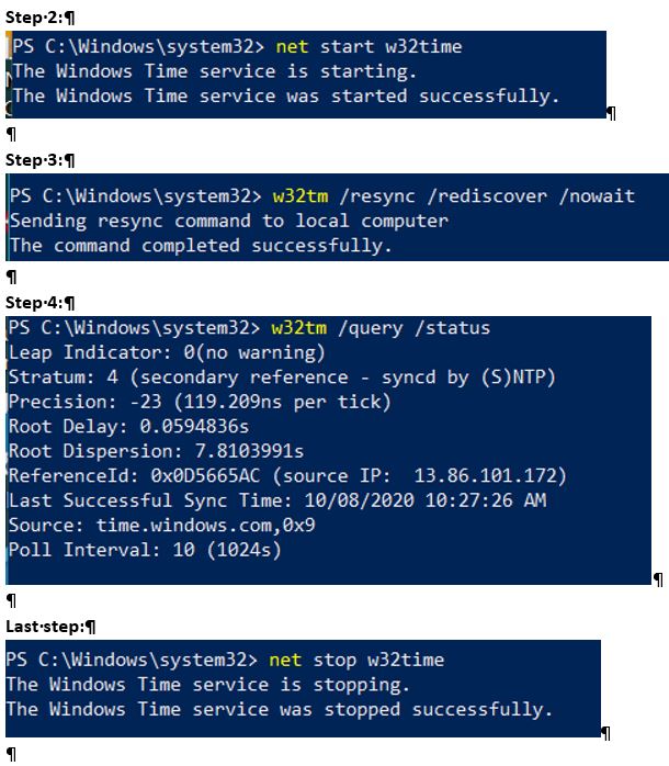

      • #2302526
        Post back to let us know whether this quick check of the Windows Time service all worked for you or if there were any errors.
        I followed your steps.
        1)  The time I recorded in Step 3 was 9:27:05. (I am not sure of why I record the time here).
        2)  My screen for Step 4 looks almost like your Step 4 screen  (some values are different: Root Delay, Root Dispersion, and ReferenceiD (of course)),  The time of the Last Successful Sync Time at 9:27:26 AM.  I had recorded the time that I hit the return in this step and it was close to 9:27:26 AM.
        3)  I right-clicked on the calendar > adjust time and date and it says that the Last successful time synchronization was at 9:27:26 AM.
        So, it looks like there were no errors.
        w32time
      Update:  at 11:04 AM, I looked again and now Last successful time synchronization was at 10:43:57 AM.
      So, it looks like the automatic clock synchronization is working on a regular basis.
      Thank you very much for your screenshots and instructions at
      #2302465

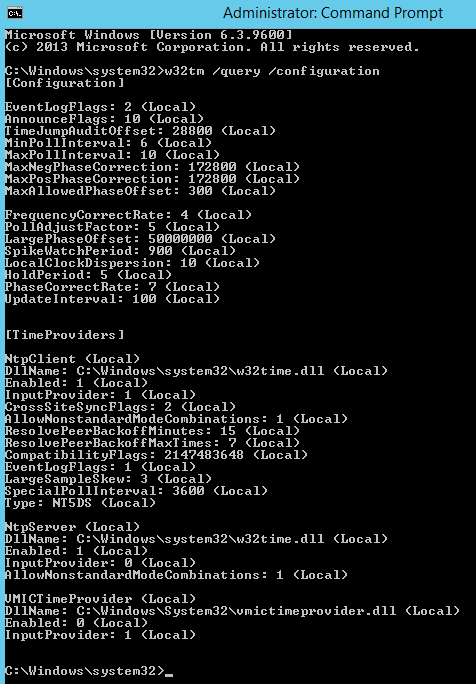

      • #2304112
        BTW this is a Windows Server 2012 R2.
        Here is the configuration:
        Capture-2
        Cheers!!
        Willie McClure
        “We are trying to build a gentler, kinder society, and if we all pitch in just a little bit, we are going to get there.” Alex Trebek
    • #2304118
      As it’s a server you seem to have it configured for domain time sync (client type = NT5DS), yet the last sync was from a “free-running system clock”.
      Is this the only server or a member of a domain?
      If it’s a member, is it the only server with the time out?
      • #2304143
