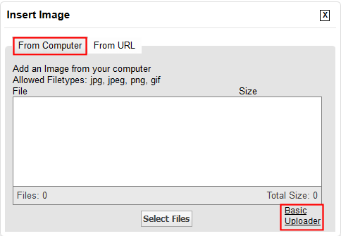

              I was going to write some instructions but found a How-To Geek tutorial that explains, probably far better than I could: How to Use the Snipping Tool in Windows to Take Screenshots
              Save the ‘snip’ as a PNG file (the default format) and use the Insert Image button to add it to a post.
              46291-snip03
              When the dialog opens, click on the From Computer tab then on the Basic Uploader link.
