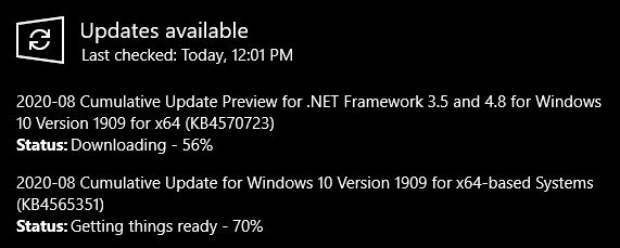

AskWoody PlusSeptember 1, 2020 at 4:48 pm #2293164At first I thought it was time to install August patches so I turned on metered and released pause and started wushowhide. But then I can’t find anything in article that says it is time to install August patches on Windows 10 v1909. So is it is or is it isn’t?
Also, when I released pause, I was not offered KB4023057. Desktop is 6 months old and it is not in update history either.
Only two patches offered, KB4570723 and KB4565351. Both are now hidden and listed as pending download.
Next time Windows checks for updates I expect they will disappear from the queue. (If I did everything right.)
Still on metered so I guess I’m safe because I can’t pause again now.

AskWoody LoungerSeptember 4, 2020 at 3:45 am #2293718Defcon hasn’t changed yet and in about one hour it will be Friday Sept 4 here. So, I decided to try to install the cumulative update for 1809 anyway.
I got very nervous because it was taking FOREVER and I haven’t one be so slow before. So, I cancelled it.
So, what’s going on with Defcon? Isn’t next Tuesday when Microsoft will release the Sept cumulative update? When will it be safe to install this August patch?
