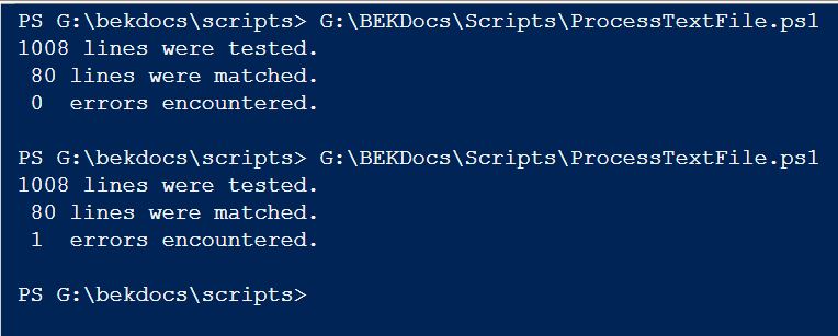

      BATcher,
      Here’s a powershell program that will do the trick.
      Code:
      param (
        [string]$ExistingFile = "WindowsUpdate.log",
        [string]$NewFile = "PSProcessed.txt",
        [string]$DriveDirPath  = "G:BEKDocsScripts"
      # ******* Setup Section *********
       $LinesProcessed = 0
       $LinesMatched = 0
       $MatchStrings = @("*Process:*", "*AUSearcher Search*")
       $MatchCnt = $MatchStrings.Count
       remove-item "$DriveDirPath$NewFile" -ErrorVariable Errs 2>$null
      # *******End of Setup Section ********
      ForEach( $Line in get-content "$DriveDirPath$ExistingFile" ) {
         $LinesProcessed++
         For( $Cnt = 0 ; $Cnt -lt $MatchCnt; $Cnt++) {
           if($Line -like $MatchStrings[$Cnt] ) {
             add-content "$DriveDirPath$NewFile" $Line
             $LinesMatched++
             break
           }  #End If
         }  #End For
      }   #End ForEach
      Write-Host "$LinesProcessed lines were tested. `n"  `
                 "$LinesMatched lines were matched. `n"  `
                 $Errs.count " errors encountered."
      Notes:
      1. You need to change the $Matchstrings = @(…..) array. Just replace the ….. with a list of the phrases you want to search for and add an wildcard * on either side. See the example. I’ve only got 2 items in the array but you can place as many as you need.
      2. All the parameters will default (lines 2-4) when you call the program you can over ride the defaults:
      [noparse] .ProccessTextFile.ps1 -ExistingFile filespec -Newfile filespec -DriveDirPath d:pathpath…[/noparse]
      as written the source and output files have to be in the same directory of course this could be changed. You also only need to include those you want to change and they can be in any order.
      3. Type powershell in the search box to get a PowerShell prompt to get started.
      Here is the sample output from 2 successive runs:
      33573-PowerShellRun
      Note the second one shows an error. That’s because I deleted the destination file and when I tried to remove it it wasn’t there. If you get more that 1 error something’s rotten in Mudville! 😆

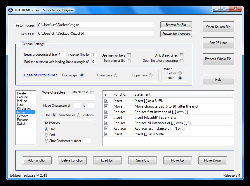

        Hi there, I had a need to do this to extract Argos (an eVisions reporting tool) actual report runtime events from a system logfile with loads of other stuff in it ages ago, and consequently it occurred to me that if I made the thing more versatile, it would save me from trying to resurrect my oft-rusting Perl/RegExp skills when I needed to do this in future with other text files.
        So, I wrote a small utility using AutoIT and dubbed it Textreme, and you can download it from my website to see if it might come some way towards meeting your needs.
        It’s available at http://www.jollybean.co.uk under the Textreme menu item on the right.
        If you DO give it a try I would be interested to know if it was of use to you!
        Best regards,
        Jim.
        [Edit] I just tried it and it appears that the Include function does not ‘cascade’ properly so that you would have to make several passes — sorry about that but thanks for highlighting a ‘feature’ that I need to work on!
        [Edit2] Okay, I think I have got both the Include and Exclude functions cascading correctly now. If you can wait until tomorrow, I should be able to upload the latest version to my site this evening (UK time). I had been meaning to do this anyway because I recently added another function (‘Move’) as a result of an article about editors written by Verity Stob on TheRegister website

      OK BATcher the ‘latest & greatest’ Textreme is now uploaded to http://www.jollybean.co.uk and ready to try. Make sure you keep the 3 files (exe, ini and chm) local to one another after extraction.
      The pop-up screen shot shows v2.3 (grr, only just noticed that!) but v2.4 is in the zip file. Because of the website builder I have used (WebPlus X6) I have to recompile the whole page to fix that but I can upload the new zip file no problem. Please let me know how you get on with it!

        Okay folks, some replies:
        BATcher – you don’t need quotes (in fact if you DO use them it will treat them as part of the search string!) and the only ‘special characters’ you need to worry about are the square brackets because these are used by the statement parser to detect the parameters. If you need to use square brackets in your parameters then there is a line in the ini file that will temporarily switch them with the characters of your choice (set to the curly brackets by default) so that the parser will not get confused. On the subject of the help file, I seem to recall having to install something from the M$ support area in order for Win7 to be able to read .chm (compiled html) helpfiles (or you might want to try some of the things mentioned here first: http://www.techulator.com/resources/4302-How-open-chm-file-Windows.aspx )

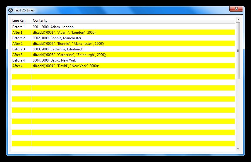

        SF99 – the best example I can offer is from The Register’s Verity Stob where she wanted an editor (Textreme isn’t one, BTW) that could do what she referred to as “munging”. The example she gave was to turn this:
        0001, 3000, Adam, London
        0002, 1000, Bonnie, Manchester
        0003, 2000, Catherine, Edinburgh
        0004, 3000, David, New York
        continues like this for 20 more lines)
        into this:
        db.add(“0001”, “Adam”, “London”, 3000);
        db.add(“0002”, “Bonnie”, “Manchester”, 1000);
        db.add(“0003”, “Catherine”, “Edinburgh”, 2000);
        db.add(“0004”, “David”, “New York”, 3000);
        At the time Textreme could do it all except the shift of the second field to the end which was what prompted me to add the ‘Move’ command.
        Here’s some screenshots of the function list that does it and the “First 25 Lines” window (not sure if I have uploaded/attached them correctly but we shall see!):
        33601-Textreme33602-First25
