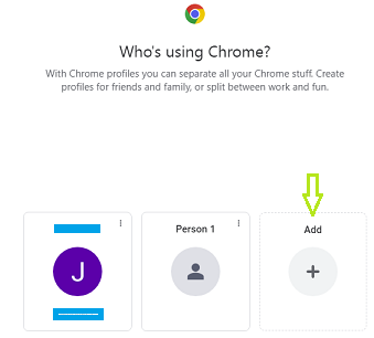

      I have little understanding of Chrome, and of user profiles / customizations.
      With Firefox, one may uninstall/install FF without affecting a user’s Profile. A common debugging process in FF is for one to create a new (for testing) Profile to see if there is any change in behavior.
      Did the Chrome uninstall and reinstall include a creation of a/the Chrome user? Or is the ‘resident’ user definition essentially unchanged?

          I just used the credentials I always use to sign into chrome for either machine
          I’m sorry: In Firefox, a Profile is that ‘FF User-ID’ the which is currently in use.
          What I’m suggesting is that you (if necessary, Close/Exit your current Chrome ‘userid’, and) create a new/different credentials/profile/’userid’.
          NewUser
          Why? We need to confirm that the problem is not some quarrel between Windows and your Chrome ‘user profile’ on this machine.
          ” to sign into chrome for either machine ”
          I understand this to mean that the credentials/Profiles on both machines are intended/supposed to-be duplicate/identical.
          In Firefox, one may delete and replace the application itself freely without disturbing existing Profiles. Are you having to completely re-define your Chrome user credentials after you’ve re-installed Chrome?
