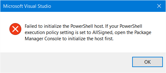

    here are the errors
    43605-2
    43606-image1
    I have power shell set to unrestricted after trying all other options.
    It is driving me up the wall – what is the problem with visual studio?

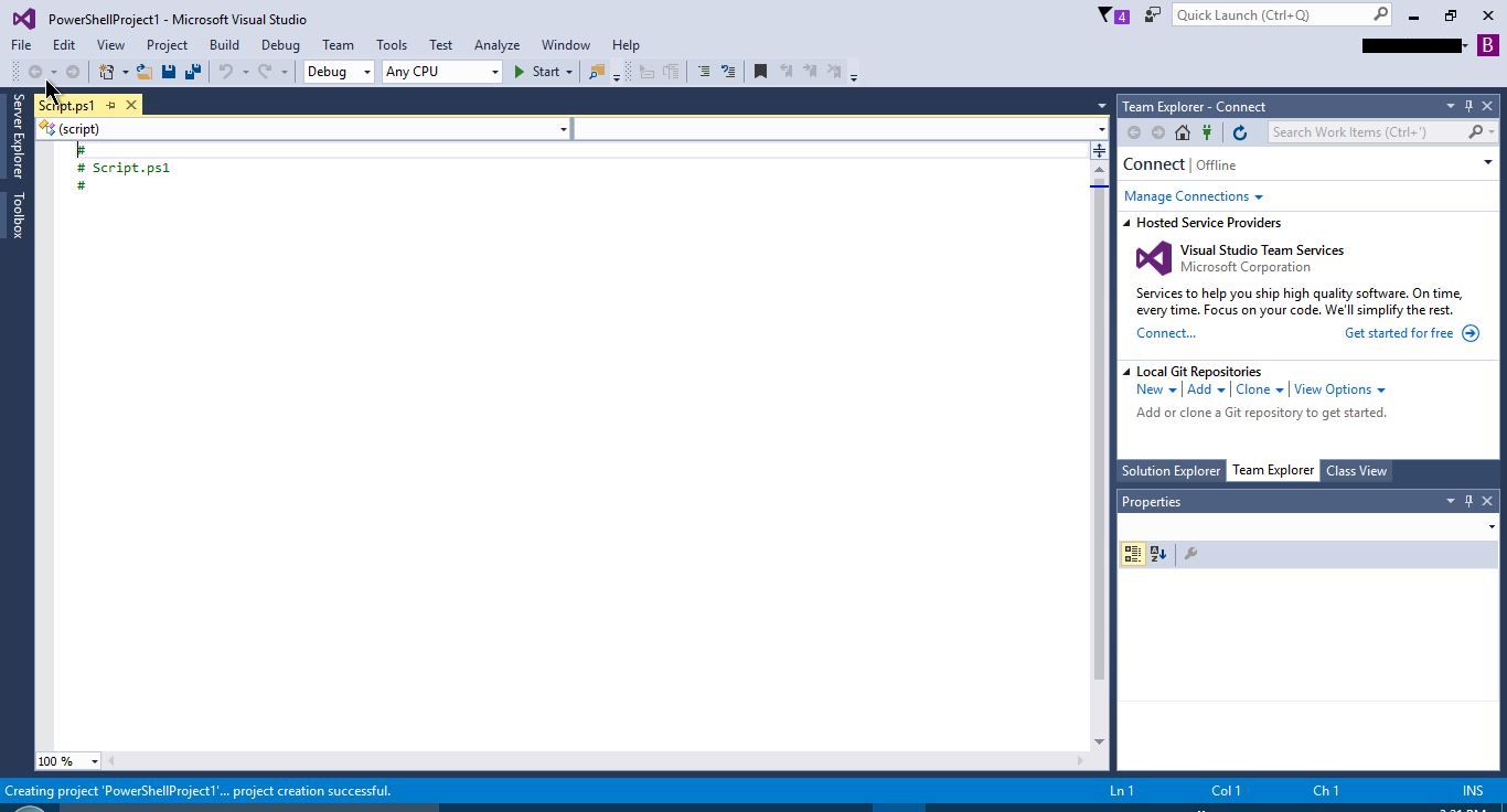

      Ok, I downloaded PowerShell Tools for Visual Studio 2015 and installed the file and was then able to create a PS Project.
      43609-VSPSProject
      I didn’t come across any errors along the way.

      I downloaded and installed the Office addin tools and attempted to create a project as specified:
      43611-VSProject2
      Look familiar?
      So I checked out the instructions:
      43612-VSProject3
      Ok so now we have some hunting to do in this unfamiliar environment.
      43613-VSProject4
      Ah! so we need PowerShell 2.0. Time to Google:
      Found this solution at Stack Overflow.
      Made the change, tried, failed again. Reboot…Success.

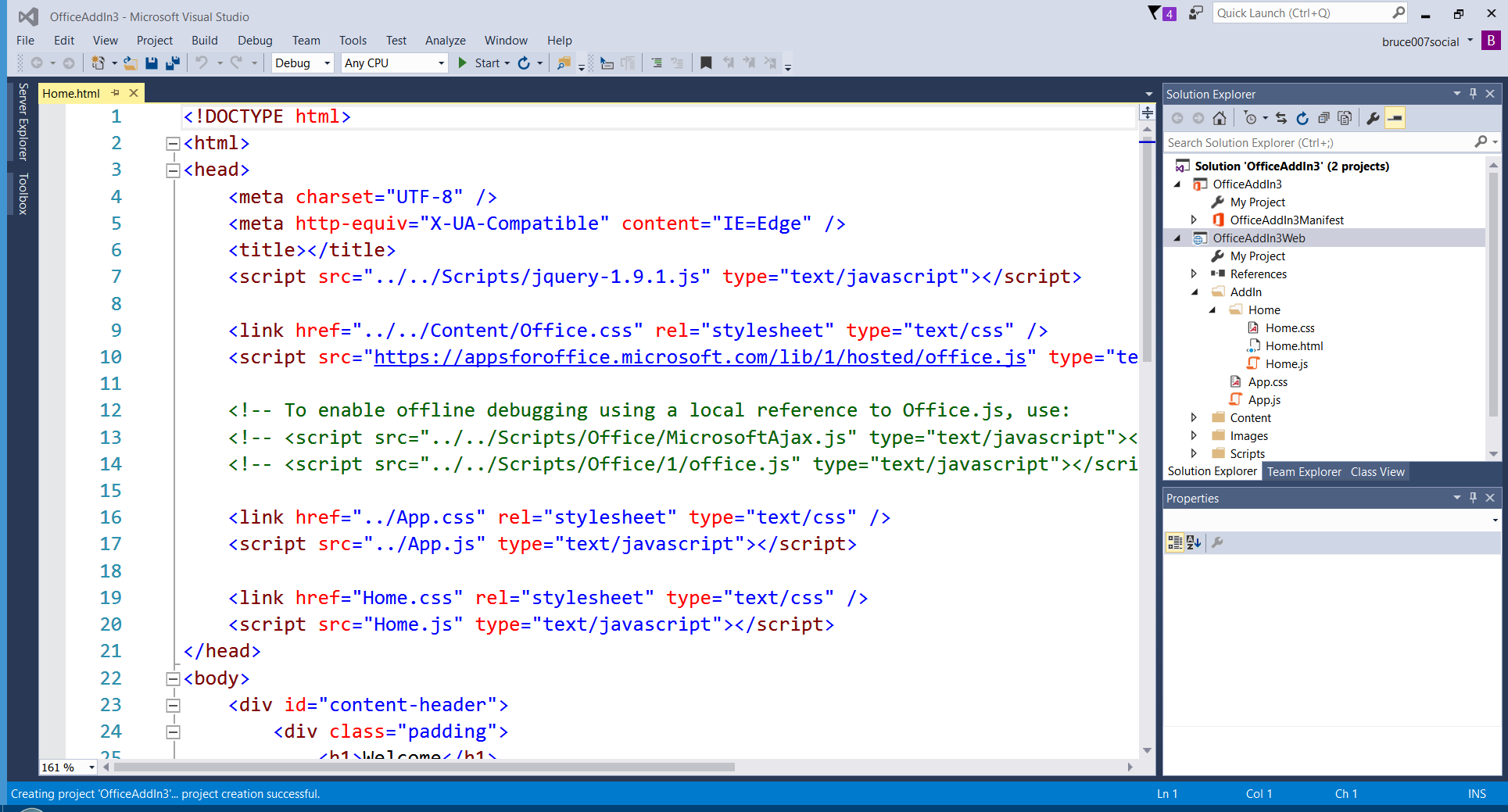

      43614-VSProject5

    • #1552240
      Hi folks,
      mini update.
      I copied a script into the config file found here http://stackoverflow.com/questions/12638289/embedding-powershell-v2-0-in-net-app-on-windows-8-rtm
      I don’t know how it works – or why – but it got rid of the errors from the power shell nugent console thing.
      I was able to open the office addin project now.
