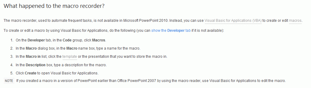

    • #1271862
      The Help for Powerpoint 2010 says that the Macro Recorder is no longer available. Instead you have to write the code yourself. To be able to do that you need to display the Developer Tab on the Ribbon.
      File…Options..Customize Ribbon. Tick the checkbox for Developer.
      27570-PPMacro
      • #1271917
        27570-PPMacro
        Thanks, John. I do know that the recorder is no longer available, that’s my big problem. I could have recorded it and at least seen what the object model objects were that I needed to manipulate. I can do this easily in Word, but am completely dumbfounded how to do this in PPT. I even tried it in PPT 2003 to see what the recorded macro looked like, but it didn’t record the PasteSpecial paste that I did!
