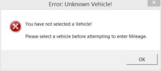

      Messages provided:
      If you don’t select a vehicle before attempting to enter a beginning mileage.
      41527-novehicle
