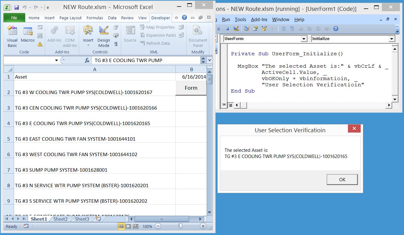

    • #1456791
      Josh,
      You just need to replace ( or just add after) the msgbox statement with: TextBox1.Value = ActiveCell.Value
      37215-Josh
      Of course you will replace TextBox1 with the name you assign to the approximate text box.
      • #1456810
        Josh,
        37215-Josh
        Worked PERFECTLY!! Thank you Sir!

        I have another question if you have the time. Is there a way to insert some function that tells if a asset has been inspected ie, turn something a different shade of color or anything at all?

        .Cells(emptyRow, 9).Value = MotorIPSTextBox.Value
        .Cells(emptyRow, 10).Value = MotorGTextBox.Value
        .Cells(emptyRow, 11).Value = DEIBTempTextBox.Value
        .Cells(emptyRow, 12).Value = DEOBTempTextBox.Value
        .Cells(emptyRow, 13).Value = DEIPSTextBox.Value
        .Cells(emptyRow, 14).Value = DEGTextBox.Value
        .Cells(emptyRow, 15).Value = ActionsTakenTextBox.Value
        .Cells(emptyRow, 16).Value = CommentsTextBox.Value
        End With
        Unload Me
        End Sub

        OK Thank you for all of that. I absolutly love your suggestions. I took what you suggested and made some changes but am getting an error now.
        So What I did was create another userform (eventually I will be creating a lot more userforms as we create different asset stratagies) named ACUserform2 and I have it being pulled up from cells C55, C57, and C60. The correct userform is being initialized but when I hit submit, I get Error 1004. I dont understand why this error is happening as it is the same code from the other form and it works just fine there.
        37247-RouteWorkingnew
        Thank you so much for your help!!!
    • #1457535
      Very simple resolution. In the code for the new form, change the 7 to a 9:
      emptyRow = .Cells(1, 9).End(xlDown).Row + 1
      You must select a column that counts down from row 2. Column 9-23 in the data sheet has a value in row 2 so changing the column to any of those will resolve your issue. If you look on the other data sheet, I chose 7 because it has a value in row 2 where the others are merged. If you were not using merged cells in the header row, any header column would be acceptable as long as it has a header value.
      Maud
