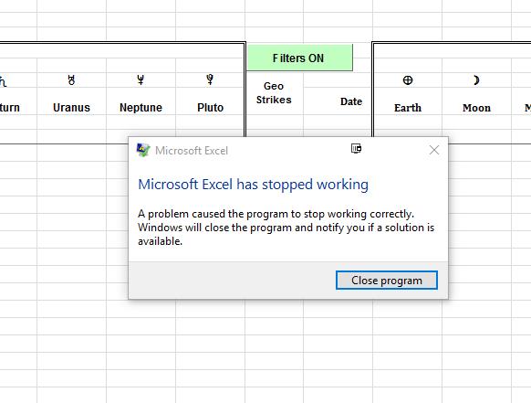

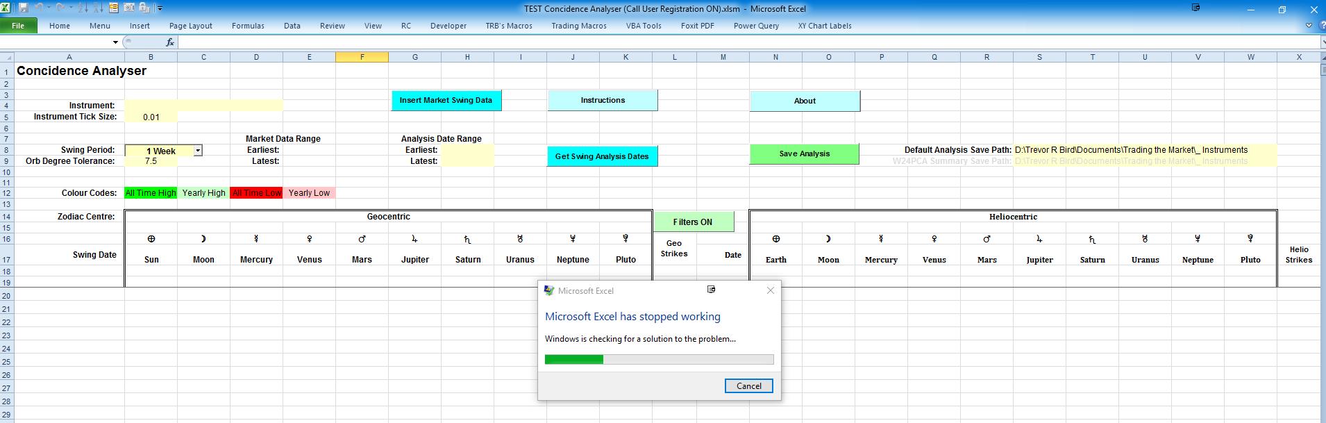

    This process works perfectly in a number of Workbooks I have created, including “TEST – User Registration.xlsm” but crashes Excel 2010 (fully updated) every time I attempt to open “TEST Coincidence Analyser (Call User Registration ON).xlsm”, resulting in the following sequence of error dialogues:
    The “TEST Coincidence Analyser (…).xlsm” contains many other VBA subroutines, all of which appear to work perfectly and should not influence the User Registration function, except “Public Sub LoadUDF(UserForm_Name As Object)” which it in turn calls. The exact same User Registration subroutines are used in other Workbooks with many more, and more complicated, VBA subroutines and they all work perfectly. It’s just this particular workbook that is causing me these errors.

    • #1586002
      Hi Trevor
      I made some changes to the vba code in the attached file.
      I’ve tested this version 5 times, and, after saving each time, the file counter increments OK.
      I no longer get the error messages you reported and no longer crashes Excel.
      I tested this with Excel2010 as per yours.
      See if this works OK at your end.
      zeddy
    • #1586070
      Hi Trevor
      In case you were wondering how I ‘resolved’ the issues you reported previously, I simply removed all references to error trapping in your routines. This forces Excel to ‘break’ and stop at the vba locations that were triggering the problem.

      • #1586111
        Hi Zeddy,
        I actually tried to post a message yesterday but it seems to have got lost:(
        Your suggestions have completely resolved the issue:) :clapping: I’d spent a lot of time (days) trying to work out what was going on before posting.
        Thanks also for your additional comments and the alternate suggested “fade-away” startup Userform. I’ll have a close look at how you’ve done that and, in the highest form of flattery, copy your approach.
        Thanks again for your assistance.
        Cheers
        Trevor
