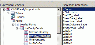

      One way to get the syntax right, and be sure you use the correct names is to use the Expression Builder.
      In the query, on the criteria line under the right field, right click and choose Build. It is slightly easier if the form is open in Design view at the time.
      On the left double click Forms then Loaded Forms, then your Main form then the Subform. now scroll through the list of controls on the subform and double click the first combo. The expression will be displayed at the top of the Expression builder, and returned to your query when you click OK.
      (If using access 2010 you need to double click the name of the database before you can double click forms.)
      30300-Expressionbuilder8
