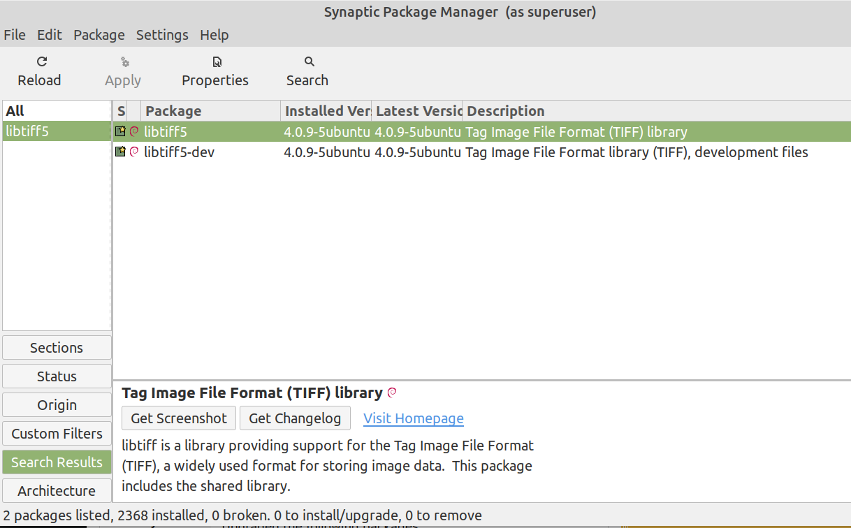

AskWoody PlusMay 18, 2022 at 12:55 pm #2447525In Update Manager when I select the tiff update and then click the packages tab, it says I have the libtiff5 package installed. When I open the Synaptic Package Manager and search for libtiff5 I see that it’s installed. When I select it and go to Edit, there’s an option to Fix Broken Packages. That might do the trick for you. Disclaimer: I’ve never done this so I don’t know if it will work. I’d probably do a bit of internet searching before I tried it, although I don’t see how it could hurt anything. If it works, great and if it doesn’t, you’re no worse off. Back in the Update Manager when I look at the Changelog it says the urgency is ‘medium’

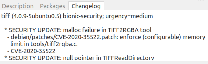

AskWoody PlusMay 19, 2022 at 7:11 am #2447644Here’s what I see in the lower pane of Update Mgr when selecting the TIFF update- notice the word ‘failure’
In Synaptic, searching as you did, this displays

DrBonzo
AskWoody PlusMay 19, 2022 at 1:15 pm #2447755The word ‘failure’ in the context above means that in the old version of the tiff package there was a “malloc failure” which is being fixed with the new patch (update); it’s not telling you about why your attempted update didn’t work (unfortunately).
