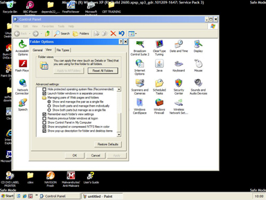

            • #1302453
              Fred
              have just found the same problem, this option is not available in XP Home, did try logging into safe mode, then as administrator, but the option is still not there, I was going to try right clicking on the services folder, but I don’t know where to find it, I only have a short cut for it, can’t do anything with the services folder when it is open
              Bob
            • #1302461
              Bob,
              As far as i know …you enter “Safe Mode” at boot time by keying F-8 (maybe different on your PC)…Regards Fred
              PS: Just found this …Open “Run” and input “control userpasswords2” (no quotes)
            • #1302593
              Fred
              Thanks for the update, still not getting anywhere, did try going into safe mode, right click on C drive and select security, then every user, allow full control in permissions, clicked advance and un-checked box for replace permission entries on child objects, re-booted, and you guessed it, still the same, will not install services, will have to have a think on this one, am on shifts at work this week, so may take a while to reply to any posts, sorry.
              Bob
            • #1302603
              Fred
              Bob,
              No problem… try this procedure
              1. Boot PC into safe mode (F-8) before the windows loading screen…(Nothing to do with right clicking on C: drive)
              2. Follow post #19 to install the “Security Tab”. So when you right click properties on any file folder you can see it. (Security Tab)
              3. Re-Boot and right click on the Macrium Reflect icon, and choose properties… you now should see the “Security Tab”
              4. Click on Security Tab , and make sure that you set yourself as owner ..and give “full control” to yourself and “administrator” accounts.
              5. Run Macrium as “Administrator” ..if it stalls …follow the error message to the folder and take “Ownership ” of it and file that the error specified ..usually some MSI .:cheers: Regards Fred

    • #1302752
      Hi Fred
      sorry I am confusing myself, I did carry out post #24 from within safe mode, have also run sfc /scannow, but did not find any errors.
      I have tried to follow your post #25, but the option is not there when in safe mode, hope you can make out the attached picture below
      29185-folder-options
      the error message says that I do not have permission to install system services, where do I go and which folder do I right click on, to try and take Ownership of it, I have not been able to find a “Services” folder, I can only find a short cut for it, I hope this makes sense,
      Thanks for all your help
      Bob
