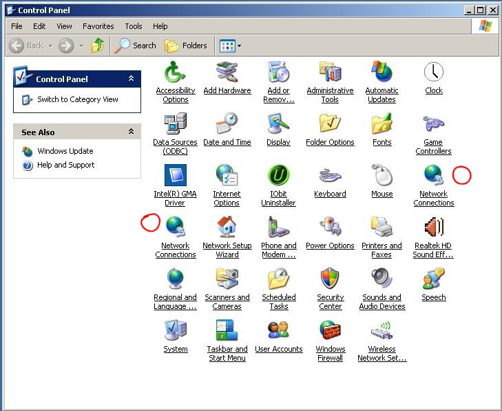

    • #1465884
      Screen shot please.
    • #1465902
      • #1466258
        Your additional network connection appears to be a FireWire port. If you’ve connected a video camera or external hard drive to this computer, that’s where it came from. If it’s not interfering with actual networking among computers/printers/etc. I’d leave it alone.
    • #1466290
      I’m not sure what you mean by “additional network connection”, perhaps you’re not sure what I mean by Network Connection icons.
      By Network Connection icons, I mean these
      37795-Two-icons
      Both computers had those two, identical, icons in Control Panel.
      The Upstairs computer’s Network Connections icons both contained two networks:
      37796-Two-network-icons
      The LAN is for the two computers to talk to each other, the 1394 is the Internet connection.
      The Downstairs computer’s Network Connections icons both contained, and still contain, one network:
      37797-Local-Area-Connection
      The operating system Upstairs, XP Home, was, last night, re-installed.
      Its Control Panel now contains only one Network Connections icon, inside which are both networks, LAN and 1394.
      Downstairs’ Control panel continues to display the two identical Network Connections icons, both of which contain the single LAN icon.
      I am guessing that your “additional network connection (FireWire port)” is the 1394 network connection? But it isn’t additional.
      The additional item is the second, identical, Network Connections icon, which still appears on Downstairs.
      This is apparently not uncommon, but the only remedy which I have seen suggested on several sites consists of deleting a .cpl file in the system32 and dll cache folders. It doesn’t work for me. They just reappear on the next boot.

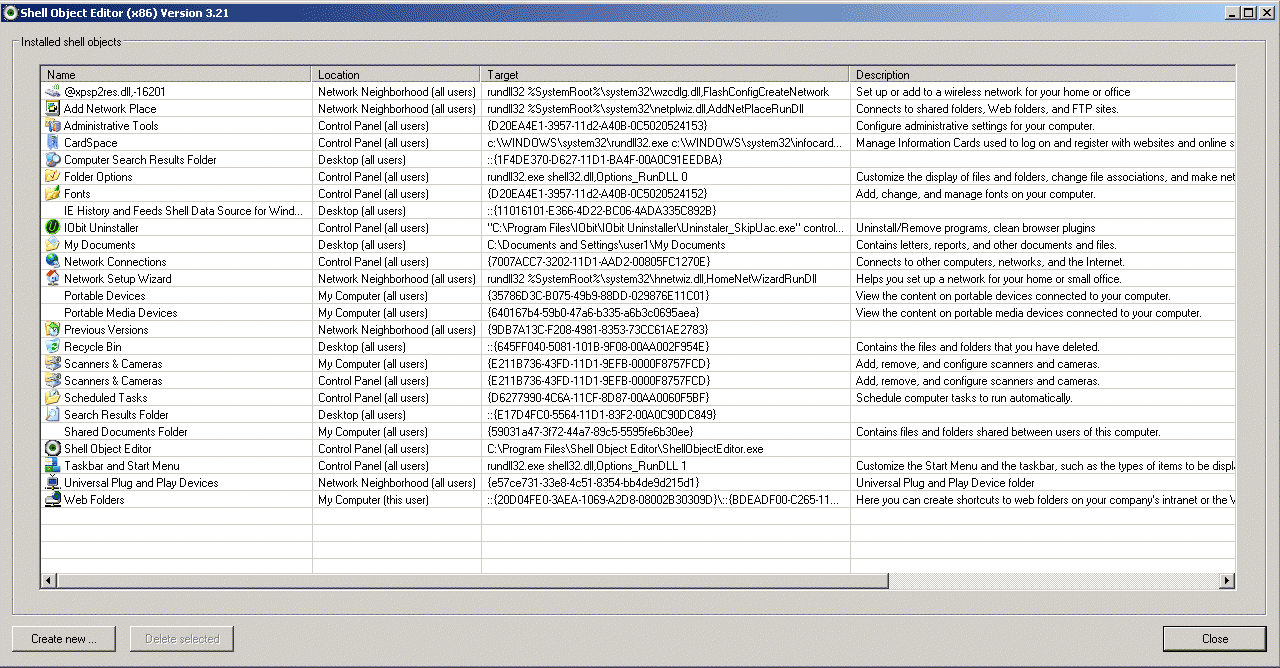

      • #1467388
        Did you download and install “Shell Object Editor”?
        If so, run the program – it should show an empty list initially because it is not in “Expert Mode” by default.
        Right-click in the window, select “Expert Mode”.
        Do NOT change or delete any entry.
        Please post the resulting screenshot.
        Do NOT change or delete any entry until being advised.
    • #1467407
      Thank you for responding, I was beginning to give up hope.
      Yes I did ack, but I had no idea how to use it.
      The result is below:
      37892-object-editor

      Try this.
      1.) Create a restore point.
      2.) Copy on paper the whole line with “Network Connections”
      3.) Delete the “Network Connections” line
      4.) Re-boot
      5.) Check Control Panel
      If it looks OK you are good to go. If not, use System Restore with the last restore point you created.
      Joe
    • #1467552
      That’s cured it Joe.
      Thank you so much for the time you have spent helping me.
