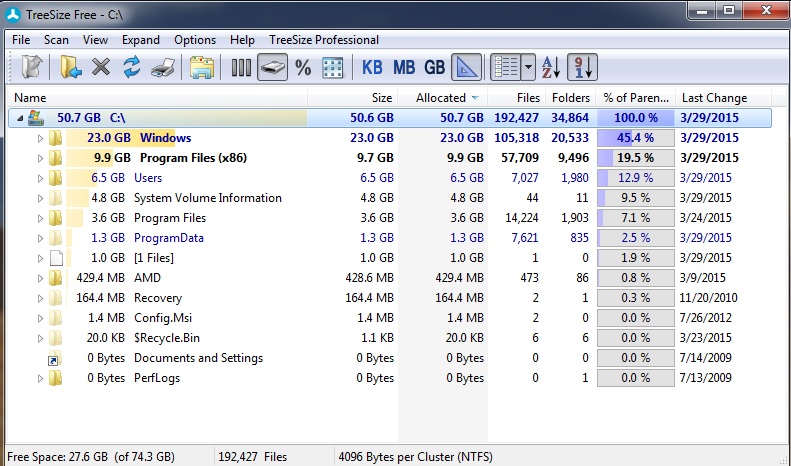

      You need to break out Treesize Free to see where all the space has gone – I run a 55GB SSD and it is 70% full.
      The profile will be on C: – you can move it to another disk if required – but the data can be anywhere. Mozbackup should use the location specified in your profile.
      • #1497885
        There are 2 HUGE files on the C drive. “pagefile.sys” is 15.9GB and “hiberfil.sys” is 11.9GB. The Windows folder is 23GB but I am assuming I can’t mess with that. But since those first 2 files aren’t IN the Windows folder, are they deletable??? Or movable to a different drive? That would solve my Thunderbird problem. I could run MozBackup to the C drive and then move it all to the F drive???
        I tried MozBackup again and I don’t see where it is even asking me where I want to restore TO. It is going to C:UsersuserAppDataRoamingThunderbirdProfilesfxkxjhfa.defaultMailpop.googlemail.com. I tried moving that folder to the F drive and directing Thunderbird to go THERE instead but it said it was not an acceptable location.
        I am going in circles…..

      How much free space do you have on C? You need to sort this out first because Windows will be VERY slow on a machine with a full C: drive and the SSD performance will degrade quickly if there is very little free space.
      When you have that sorted we can work on Thunderbird.
      • #1497869
        The SSD drive is 80GB and came to me with only 6GB free. I have installed everything possible on the F drive. Right now it says C has 2.27GB free of 74.3GB. It varies dramatically, though, for reasons I don’t understand. One time it was 736 MB free. I have run CCleaner and defragged to try to stay afloat. That’s why putting Thunderbird on the C drive is unthinkable! Thanks, Paul…..Sharon
    • #1497886
      You can reduce / remove both of those files.
      If you do not hibernate your computer you can remove hyberfil.sys. Following the instructions in this article: http://www.techrepublic.com/blog/tr-dojo/delete-hiberfilsys-by-disabling-windows-hibernate-function/
      Reducing the size of pagefile.sys is more complex. Follow these instructions to show the Virtual Memory use and post the answer here: http://blogs.technet.com/b/danstolts/archive/2013/01/07/how_2d00_to_2d00_change_2d00_the_2d00_size_2d00_of_2d00_virtual_2d00_memory_2d00_pagefile_2d00_sys_2d00_on_2d00_windows_2d00_8_2d00_or_2d00_windows_2d00_server_2d00_2012.aspx

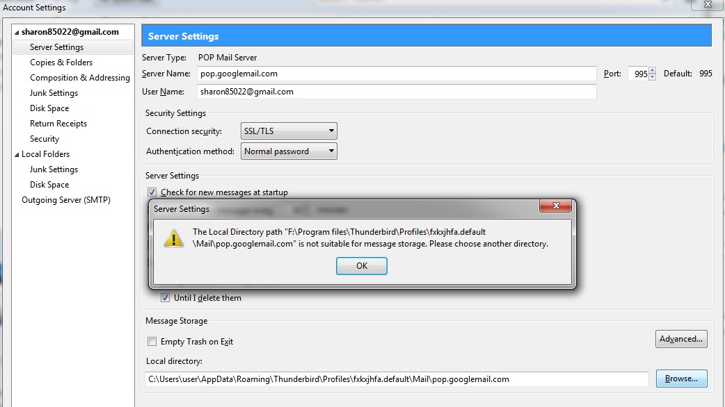

        In this on-going saga, I have learned a lot but obviously still don’t know even more! I tried with the smaller of my email accounts only on the new PC to move its profile location to drive F and redirect Thunderbird to the new drive F folder. It still tells me no. What am I not understanding, Paul, do you know? Thanks for your patient help….Sharon40050-F-not-suitable-for-mail-storage-033115
        Messing with Windows is always a good idea, but it does require you have a proper backup regime in place. 🙂
        Post #12 in this thread shows how to move the data to another disk.
    • #1498135
      I suspect that message means the folder doesn’t exist. You should create a folder for you mail before attempting to move the mail. I’d use a much shorter path, something like: F:Thunderbird
      1. Shut down Thunderbird.
      2. Copy your mail to the new location.
      3. Start TB.
      4. Change the local directory.
      • #1498231

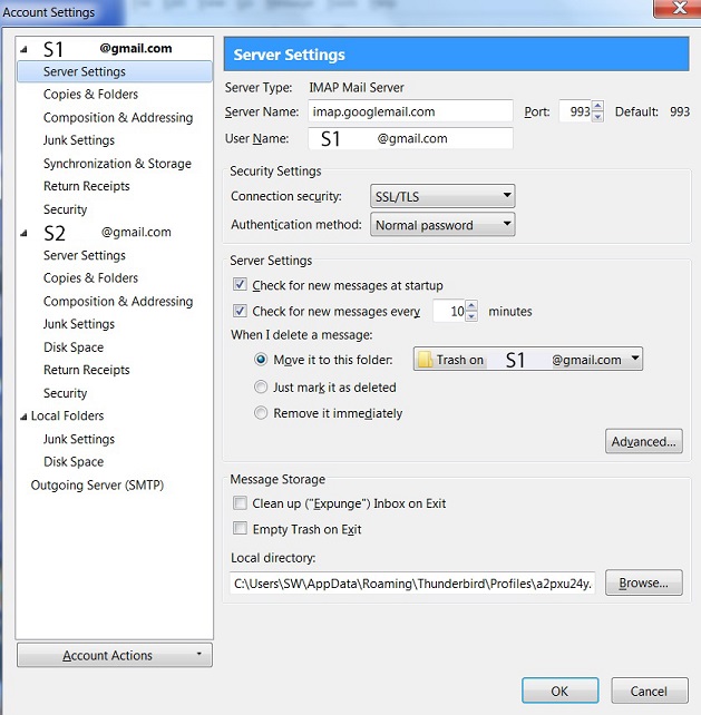

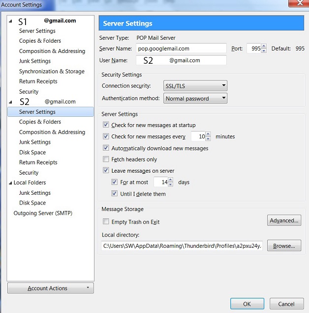

        Paul, don’t hate me….I evidently left out some important details. I followed your directions re the folder on F drive not being named so complicated and redirected Thunderbird there and WOW, it started working! I was SO excited! For a few minutes anyway….. :huh:
        I assumed – wrongly I now know – that if I selected the options of “General Settings”, “Emails” and “Address Book” in MozBackup, that it would transfer over BOTH of my gmail accounts AND all my Local Folders I had set up and had filters for. That didn’t happen. All my emails went into S2, no doubt my fault, because that’s the lesser used account and I set it up on the new PC as a test to see what went where on my new PC. S2 didn’t know about the S1 account, nor did it know about all the folders I had set up.
        So if you have patience left to deal with my situation, can you advise how to actually DUPLICATE the setup I had on my old PC, with TWO gmail accounts working happily together, and both filtering messages into folders? As you can see, one was imap and one pop and I have no idea why. When I set them up long ago I wouldn’t have had a clue what that meant. That is probably part of my problem as well. My apologies for being inadvertently dense…..Sharon
        40060-S1-thunderbird-settings40061-s2-thunderbird-settings
        3. Start TB.

      I don’t know you so there’s no chance of me hating you – not much chance if I did know you. 🙂
      Having 2 accounts means you can’t redirect by changing the location of the account in TB. You need to follow the instructions for moving your profile.

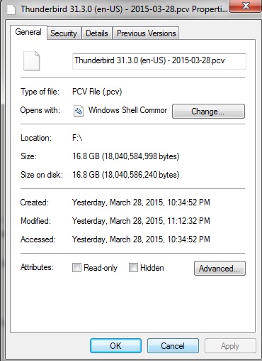

        I got hopelessly lost in the directions on that link for moving my profile, Paul, even with several re-reads, so I did it a convoluted way. I opted for Thunderbird in the first place when I had to use a Windows email system because the others wouldn’t let me embed images in the text where I wanted them, but now gmail online does allow that, so I could have just gone that route and not gone through this long odyssey with Thunderbird. Except that I had a lot of old emails I wanted to keep and that inspired my dogged pursuit of moving them and repeated questions to you. By a pretty unorthodox route that made sense to me but I would probably never be able to duplicate (!) I did finally succeed, greatly helped along the way by your comments. I definitely didn’t want Thunderbird on drive C and it’s on drive F now. My primary “S1” and secondary “S2” eddresses are present in my “new” Thunderbird, and all my filters and “Local Folders” (which ended up with its own separate folder on drive F) are there and working! As an added bonus, thanks to your superb information on hyberfil.sys and pagefil.sys, I have 26.9GB free on drive C, out of the 74.3 available for the 80GB SSD drive, whereas before all this I had less than 1GB free, so you helped me tremendously with Thunderbird AND with drive C space! Thanks so much…..
    • #1498570
      I assume you just installed TB to F. I should have thought of that!
