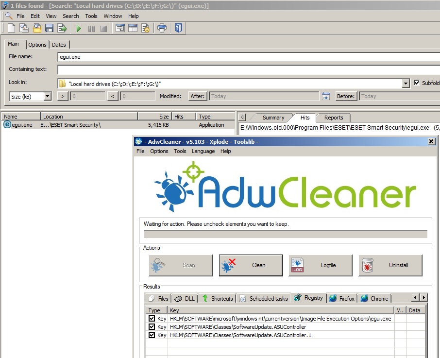

    ADWCleaner results (incidental to the main topic, probably FPs).
    43956-ESETAppleFP
    EDIT: ADWCleaner's 'finds' were indeed false positives, rapidly fixed.
