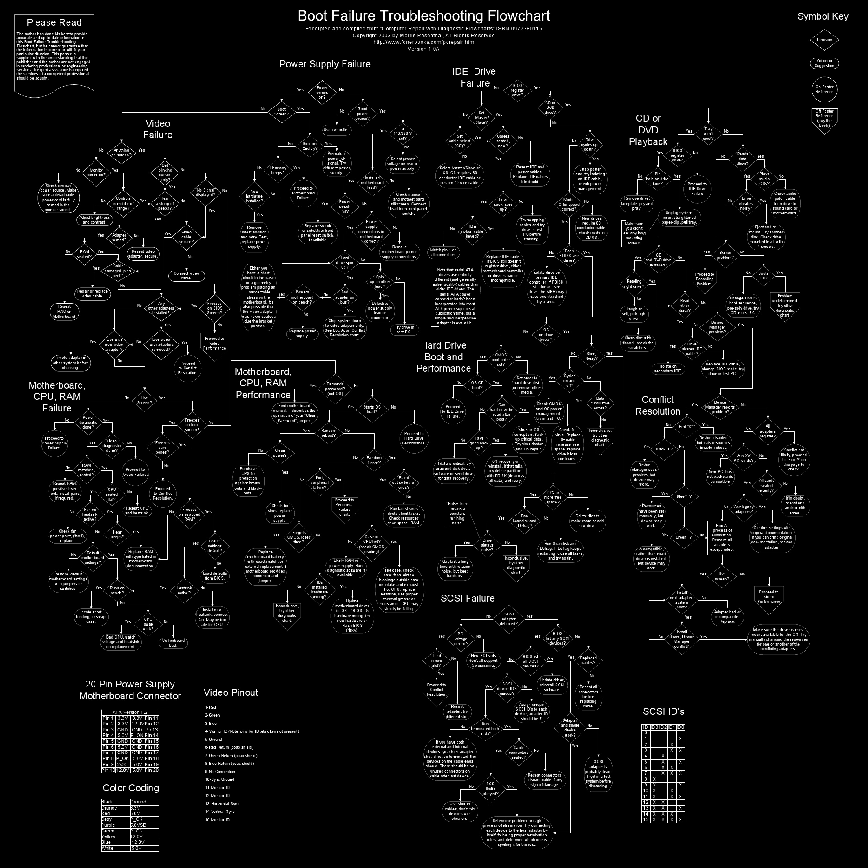

AskWoody LoungerFebruary 21, 2015 at 12:41 pm #1491652Have a look at some of these:
Computer Repair with Diagnostic Flowcharts Third Edition – PDF Now Available39512-Boot-failure-troubleshooter
Some of the above charts in the link look very useful.
WShandcuff36
AskWoody LoungerFebruary 21, 2015 at 1:22 pm #1491666Thanks, Clint, I followed all the pertinent flow-charts and ended up always at a dead-end. But very interesting, thanks.
