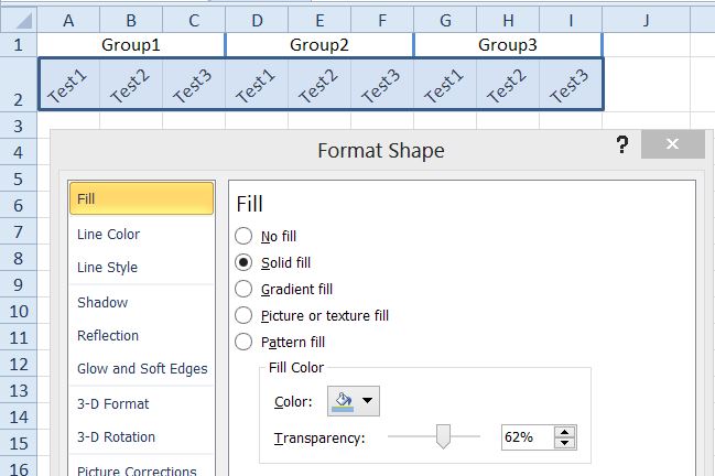

      • #1403388
        Another hack and whack way would be to use Text boxes for the headings you want.
        You can then place these textboxes wherever you want.
        zeddy
    • #1403391
      Andy,
      One more option is to use a shape for the border on the slanted titles since you can place and size the shape where ever you want just make sure to set the transparency! HTH :cheers:
      34486-SlantedHdrBoarder
      BTW: I used regular boarders for the Groups.
