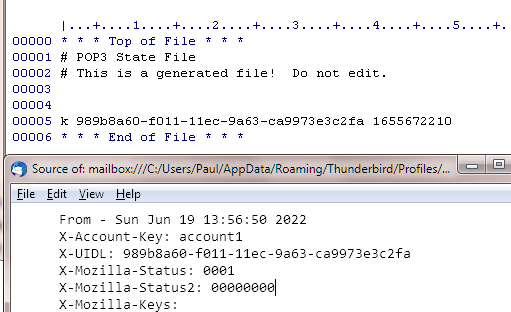

      In Thunderbird: POP (for sure; I don’t use IMAP so cannot assert this, but I think that it also is true (perhaps someone can confirm this)); and ‘Leave messages on server’ is checked;
      and an email is read in —
      there is added to the file popstate.dat a line that uniquely identifies that email.
      When a user subsequently does a Get Messages, TB checks the popstate file to see if the download-candidate email already has been read/downloaded. TB will not re-download from the server a previously-read-in email.
      This is a Thunderbird function, independent of an email source.
      In Windows it is located at –
      C:\Users\logon_name\AppData\Roaming\Thunderbird\Profiles\profile_name\Mail\account_name\popstate.dat
      The following should be done with Thunderbird closed.
      It is safe to delete the file. The next Get Messages will re-retrieve ALL the emails in the server’s Inbox. This will result in duplicate messages in the TB Inbox. It is safe to edit (Notepad) the file, but there is no simple way to cross-check which (popstate) line is for which extant email in the TB Inbox (or elsewhere, if an email has been moved to another folder).
      Technically, the id of a line in popstate matches a line within the identifying lines of an email as it is stored within TB. Note that this line is not part of the email (as transmitted over the internet) itself, so it is not displayed by setting
      View > Headers > All.
      Example, copied from a test email run –
      In Popstate: b 55dd873c-ef62-11ec-9c52-288dd071c2b2 1655596630
      Email: X-UIDL: 55dd873c-ef62-11ec-9c52-288dd071c2b2
      [Disclaimer: The above is from an intentionally old version of TB. There may be changes in more current versions.]

        OK, here are some changes to 2454392 above and 2454406 below; and additional info.
        I’ve installed Thunderbird 91.10.0, the current release, and tested both POP and IMAP accounts.
        1 – File popstate.dat is still used in TB 91 in the POP account.
        2 – The file name is POPstate, it does not apply to IMAP. (The IMAP account has no ‘Leave messages on server’ option; ‘leaving on server’ is inherent.)
        3 – To match the content of a line in popstate.dat to an email:
        3a – Click on an email
        3b – Either View > Message Source (Ctrl+U); or
        3c – in the message pane, click on the [More – down-arrow] at the right end of the header line, and View Source.
        4 – Here are clips from a test email today. (Line 4 contained my server name and email address so I snipped them out.)
        X-UIDL
