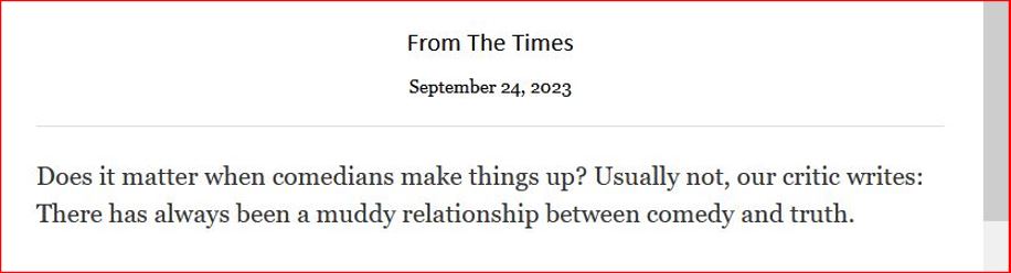

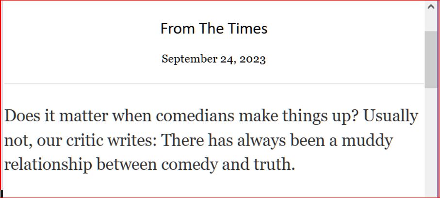

    I’ve just upgraded to Thunderbird 115 from 102.
    I can’t figure out how to reduce the font size in the messages that show up in the left-most panel.
    This is the font size in the Message Panel on the left in TB 115:
    TB-115-font-size-in-Message-Panel
    This is the font size in the Message Panel on the left in TB 102:
    TB-102-font-size-in-Message-Panel
    Under General > Language & Appearance | Fonts & Colors, the settings are the same for both 115 and 102. But 102 is rendering the font smaller than 115 is. I’ve played around with font sizes in 115, even under the ‘Advanced’ button, including unticking the boxes under ‘Font Control’, but no changes seem to be happening afterwards, even after closing TB and opening again. Resizing the TB window doesn’t change anything either.
    How do I change the font size in the Message panel?

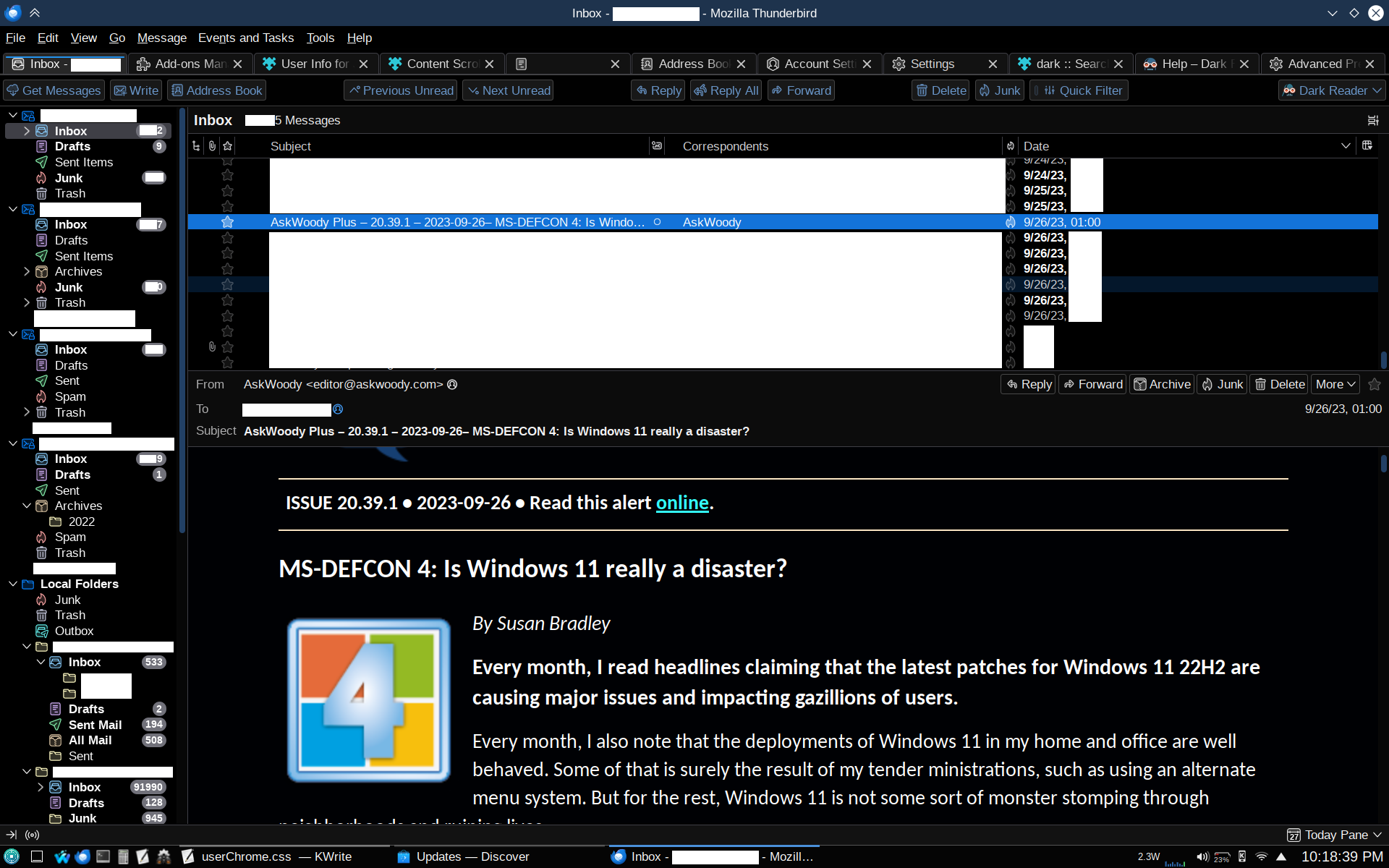

      I started to write a bit about my impressions of TB 115, but it became another long post about UI design and the friction between people like me who desire maximally usable tools and designers who want things to look pretty. Fortunately, I was able to undo the silliness in Thunderbird 115 and make it as good as or better than previous Thunderbird, using a crude userChrome.css stylesheet I wrote over the past couple of days. I can post it here if anyone is interested, but it will likely need tweaking to be “right” on different PCs. Even moving it from my 14 inch laptop to my 13 inch laptop made things look a little “off.”
      I am not sure if the older Thunderbirds had this, but there is a pref to set the UI font size specifically (not using the font settings UI). It’s ‘mail.uifontsize’, visible within the Config Editor in Thunderbird’s settings (first page in settings, scroll all the way down, on the right). By playing with that and the pixelsperpx setting, you have a little more space to customize the UI to your liking, should you desire to.

    • #2590246
      Sure. I am using a dark theme here, but the layout would be the same with any other colors. Please excuse the redactions to eliminate sensitive info!TB115-1
