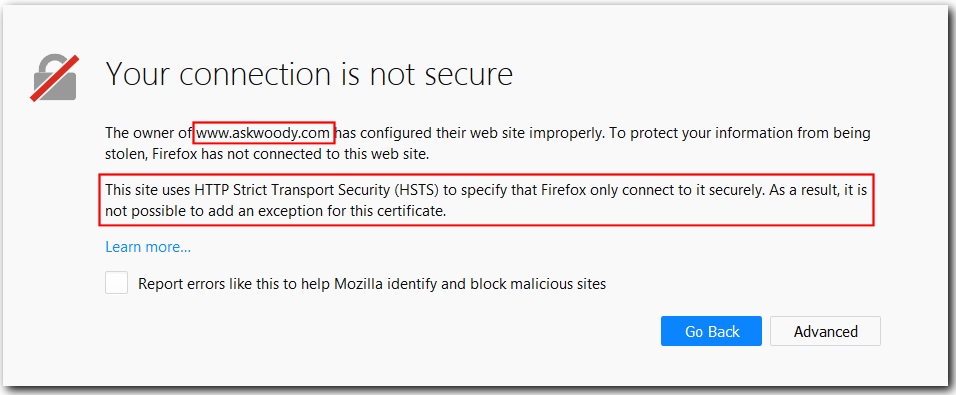

    • #203751
      But Woody’s site is not using Strict Transport so there should be an exception button on the Fx window that you can click to override and come here anyway.
      woody-cert
      Sure looks like Strict Transport (HSTS) to me and Firefox Quantum will not allow an exception.

      What i get in my address bar is a Red Triangle with a asterix in it followed by in red Not Secure with the Https lined out in red and then the rest of the address being in black ://www.askwoody.com/forums/topic/things-i-learned-last-night/
      I sometimes find it hard to explain issues after suffering a couple strokes in the past so a little help and clarification is highly appreciated.
      On another note i am not sure whether to use the Visual or Text format when posting on your site as on a previous post of mine in regards to favourite tools ( CCleaner ) there was a tag added to the bottom stating something about editing and formatting when one adds a link source or capture.
      I have posted this using the Text Tab.

        https://www.ghacks.net/2018/06/27/firefox-61-fix-secure-connection-failed/
        thank you
        • #204265
          Yes, it should be 4 for FF 61>, I’ll amend this in the AKB. For now, you need to use the side-door to access askwoody until the certificate issue is sorted.
    • #204270

      Once the proper cert is installed there is no propagation delay – the site will be fixed.  I know certs are confusing and difficult the first (and maybe second) time you have to deal with them, but it’s now been 4 days….  GoDaddy’s certs are insanely expensive, but their SSL helpdesk is extremely knowledgeable and available 24×7.  Let’s Encrypt certs are free and difficult to wrap your head around, especially for someone with no cert experience; but once they’re set up correctly you’re done. LE certs are valid for 90 days and will renew automagically every 60 days – if the renewal fails for any reason LE will start emailing you to inform you that there’s a problem with the cert renewal and you have weeks to fix it.
    • #204566
      Yay! Up and running in FF 61.0.1, 7:05 PM MDT
