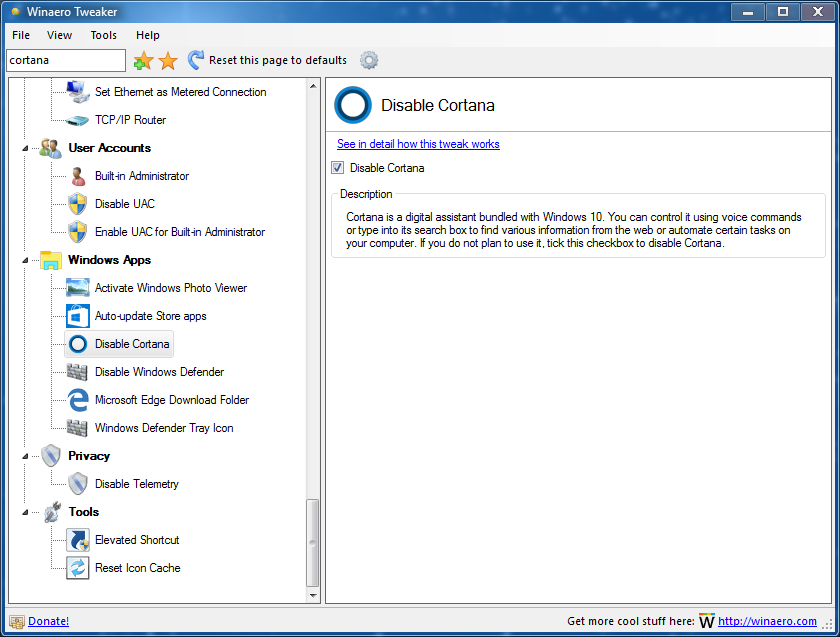

GuestNovember 7, 2016 at 9:13 am #24020By the way, I ran across a panel in the “WinAero Tweaker” tool that promises a one click fix to block Cortana…
http://Noel.ProDigitalSoftware.com/ForumPosts/Win10/14393/WATCortana.png
I don’t personally know how effective it is or whether it blocks SearchUI from running, because I had already expunged Cortana before trying the tool. It offers a lot of other nice tweaks too.

GuestNovember 7, 2016 at 4:41 pm #24035And that little comment worked. Interesting!
I tried the WinAero script quite a while ago, and it worked for me. This was probably the first few months of 2016, so it was not a current build… but it worked fine, no BSODs or other such things. I’d also purged MS Store, Edge, etc., and everything else “app” I could. I was already using Classic Start, so I never noticed the issue WinAero mentions with the start menu.
ch100
