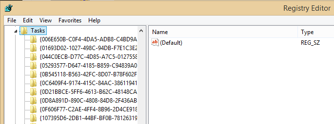

AskWoody MVPApril 29, 2019 at 10:48 am #1101639The selected task “{0}” no longer exists
The implication is that you have a task with a corrupt UUID.
Do you have a weird entry under the registry key HKEY_LOCAL_MACHINE\SOFTWARE\Microsoft\Windows NT\CurrentVersion\Schedule\TaskCache\Tasks?
Normally you’d see a bunch of UUIDs.cheers, Paul

AskWoody MVPMay 1, 2019 at 12:56 am #1158194should an entry with a UUID show up that way?
No, it should have information. Back up the entry – right click, Export – and then delete the entry. Restart and let us know.
Moonbear
AskWoody LoungerMay 1, 2019 at 7:45 am #1168376I followed your directions and I think it worked. My PC was rebooted a little over an hour ago, nothing shows up in the Event Viewer for the task scheduler and I can open the task scheduler with no error messages. So far everything seems back to normal. Is there anything else I should check?
