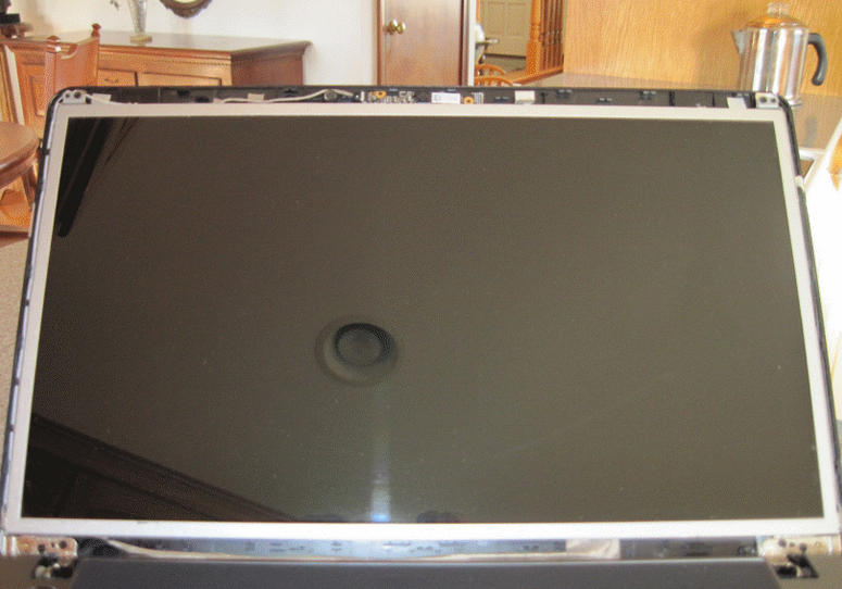

AskWoody PlusJanuary 24, 2020 at 8:34 am #2100164Update- Lid trim removed- inverter not visible. Looks like further disassembly required.
Just had a response to one of my inquiries yesterday, asking for part # of original. Diving into that later today.

AskWoody PlusJanuary 24, 2020 at 2:22 pm #2100312Currently have laptop base opened, flat cables not disconnected, but I can see the components- there is nothing in there that looks like the descriptions and pictures I have seen of an inverter. At this point, I believe I have seen everything there is to see in there.
Is it possible that the second photo posted earlier, and ID’ed as a Skype camera, is actually the inverter?
Here’s a closeup of that part. I’m sure the black “flower” in the center is a Skype aperture, as it sits directly behind the hole in the screen surround.I have not removed the display from the lid, but is the inverter ever located behind it?

If this problem is on the Win7 side of the double boot, did you just install the January Win updates?
Seems both the Rollup and the SO both have a black screen bug if the desktop picture is set to Stretch.2 users thanked author for this post.
Slowpoke47
Just Lurking
AskWoody LoungerJanuary 25, 2020 at 10:51 am #2109777@ PKCano
Seems both the Rollup and the SO both have a black screen bug if the desktop picture is set to Stretch.Ah, excellent question–but I think there is a hint that answers that question here:
Yes, it’s so nearly black that the only reason I can make out anything- i.e. Mint logo– is that I know what I’m looking for.
Slowpoke47
AskWoody PlusJanuary 25, 2020 at 1:06 pm #2109980You’ve read all the hoorah about MS’s last patch for Win7, I suppose?
I stopped patching Windows around Nov. when the advice here seemed to get somewhat ominous. At that time, almost fully moved to Mint, there seemed to be no compelling reason to continue updating Win7. Looked to me as though MS had abandoned Win7 long before now.
Slowpoke47
AskWoody PlusJanuary 25, 2020 at 1:15 pm #2109981Seems like my best strategy now, given the info posted to this thread, is to continue looking for a vendor offering a screen for this model, and ask about the question of inverter or no inverter. Having tested using a remote screen as advised here, and found the laptop functional with that config, my understanding is that either the display or the inverter has failed. As is often said in reference to other types of repair venues, “if it ain’t there, it can’t fail.” So- if no inverter, a new screen should be the answer.
If no vendors offer an inverter for this model, that’s a substantial clue that there isn’t one.
This reply was modified 5 years, 3 months ago by
Slowpoke47.
Slowpoke47
AskWoody PlusJanuary 30, 2020 at 12:29 pm #2112083New display installed. This machine back in operating condition, once again thanks to the assistance here. My appreciation for this rescue.
A postmortem question- would it have been ok to magnetize the screwdriver to facilitate handling those nano-screws? I was afraid there might be some unwanted consequences to the memory or suchlike.
Bluetrix
AskWoody MVPJanuary 30, 2020 at 2:44 pm #2112158would it have been ok to magnetize the screwdriver to facilitate handling those nano-screws?
Not a problem.
The driver is so small you would need a million of them right on the HD to “possibly” damage it. Even if a magnet could damage an old HD it would have to be MEGA larger than a screwdriver (and spinning), to the tune of if your hand were caught between the magnet and a steel plate you would lose the use of that hand.
Ascaris
AskWoody MVPJanuary 30, 2020 at 9:03 pm #2118195Absolutely agreed. I’ve read about people doing experiments, trying to damage the data on a hard drive with strong magnets (thousands of times stronger than a magnetized screwdriver) right on the hard drive’s case, and failing. It’s difficult to damage the data on a hard drive with an external magnet!
Inside the hard drive is a powerful rare-earth magnet to drive the head (the actuator uses pulses of an electromagnet of the opposite polarity to move it). Some people like to open up old drives to get the magnet out when disposing of them!
Hard drives are quite regularly installed in close proximity to other hard drives (that also have powerful magnets inside), so they’re either really well shielded, or the platters are not nearly as coercive as it would seem at first. A little of each of these, I think!
Acer Swift Go 14, i5-1335U/16GB, Kubuntu 24.04 (and Win 11)1 user thanked author for this post.
Bluetrix
AskWoody MVPJanuary 31, 2020 at 11:05 am #2123800New display installed.
Do you mind sharing the vendors name? It appears they were very helpful and quick! That’s something that should be shared. (it’s not an advertisement, share a link please)
Congrads, well done!
Just Lurking
AskWoody LoungerJanuary 30, 2020 at 6:24 pm #2113097@ Slowpoke47
New display installed. This machine back in operating condition, …
Hey! Congrats on a successful repair!
Thanks for letting us know.
Slowpoke47
Slowpoke47
AskWoody PlusJanuary 31, 2020 at 12:49 pm #2123857New display installed.
Cruised about online, found only a few vendors showing listings for the display we needed. Two showed “out of stock” and the best currently available source was… Amazon! The hits resulted from a Duck search, which also produced several dead ends, even though the search terms included the specific make/model of the laptop as well as the p/n of the screen.
My practice when searching for a multi-word target is to connect the whole mess with + symbols and without spaces, but that doesn’t always filter the hits. Could be that the 17.3″ size is less common.
Although sold by Amazon, the vendor was http://www.eastcoastlcds.com, but their site consists of one mostly blank page that shows only an email address and phone number. Could be they do not sell direct. The Amazon link for the display we needed is Amazon.com: New LCD Panel For ACER ASPIRE E1-731-4699 LCD Screen 17.3 1600X900 Standard: Computers & Accessories
From order to delivery took 3 days- pretty good service!
Other hits were
acer lcd screen replacement+”aspire e1-731-4699 – Newegg.com
Contact Us : NY Laptop Parts . Com, Laptop screen Laptop parts inverters and more
Screen for Acer ASPIRE E1-731-4699. Replacement Laptop LCD Screen
PKCano.
Slowpoke47.
