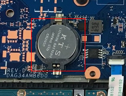

If you haven’t made any changes to the hardware yourself then it may be time to replace the tiny CMOS battery that keeps the Real Time Clock (RTC) chip going when the device has neither mains nor main battery power, otherwise you’ll see this message every boot.
Example of a CMOS battery in an HP laptop:
Sites like iFixit.com should show the steps involved in replacing the CMOS battery.
