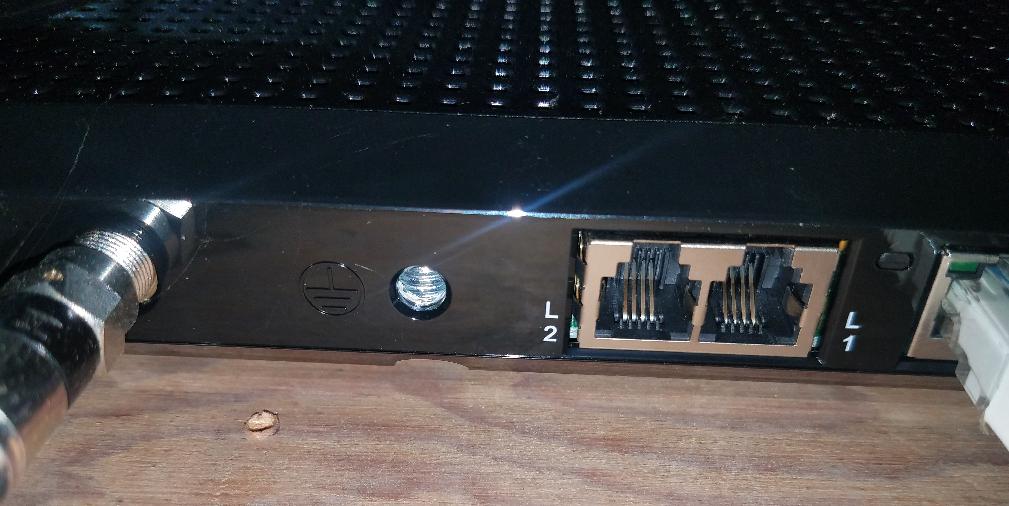

I have Fios but I do not have Fios Digital Voice. I just know that you can use any router you want. According to Verizon, the ONT does supply the FDV. https://community.verizon.com/t5/Fios-Digital-Voice-and-POTS/hardware-installation-question/td-p/1578755
If you get the Fios Digital Voice this is a Voip but the software is handled at the ONT. You do not have to plug your phones into a modem as you would use your existing phone jacks in the house. We connect the existing copper wire up to the ONT.
Frank_VZ
Here is a press release https://www.verizon.com/about/news/press-releases/fios-digital-voice-heres-how-it-works
And here is a picture of my ONT with the RJ11 jacks.
Charlie
AskWoody PlusMarch 25, 2024 at 1:22 pm #2653401This back box looks exactly like what I have installed on a wooden board in the basement, and this is where my phone line is connected (L1). It also has the Internet connection line running up to the “modem”/router upstairs. I don’t see anything adjustable on the outside, and a Youtube video only describes what the you see on the outside and what the LED lights indicate on the other side. They don’t say what that little clear opening is for and that intrigues me, but I dare not fool around with this unless I could be absolutely sure of what I was doing.

AskWoody LoungerMarch 25, 2024 at 2:02 pm #2653413This back box looks exactly like what I have installed on a wooden board in the basement, and this is where my phone line is connected (L1). It also has the Internet connection line running up to the “modem”/router upstairs.
The coax on the left also connects to the router for MoCA and QAM, since I have TV and Internet, no FDV phone.
You should really force Verizon fix your service. Maybe it needs a new ONT. If not, look at alternatives. For example, I currently use the VOIP service Ooma, where I am Grandfathered in on their free, no tax service. (They still say it is free after paying for the adapter, but they now charge monthly taxes.) But, I would first demand support if FDV is what you want.
